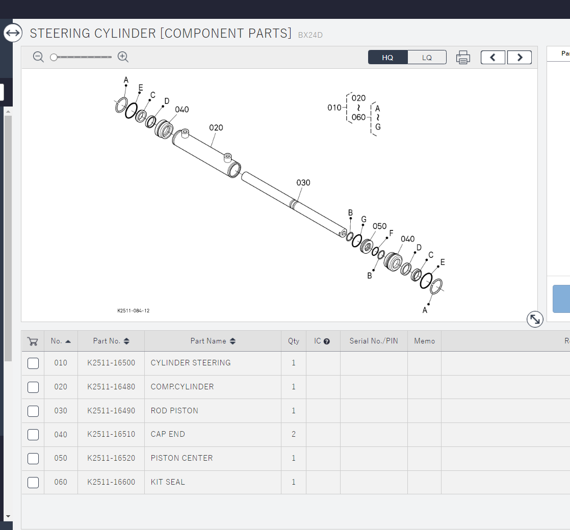

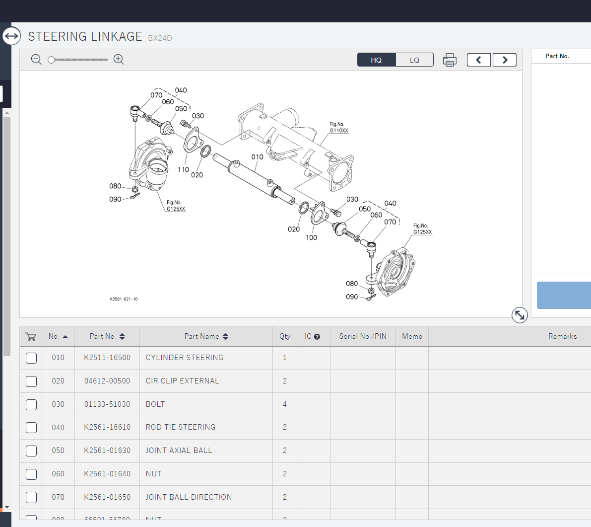

Repair steering cylinder on 2006 BX 24 Kubota
