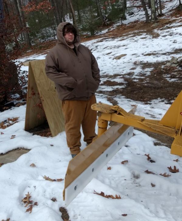

I bought a piece of UHMW (1/2"x6") for mine. Used the same bolts and holes from the steel edge. Was $77 w/shipping from usplastic.com The trex decking is a cheaper option.

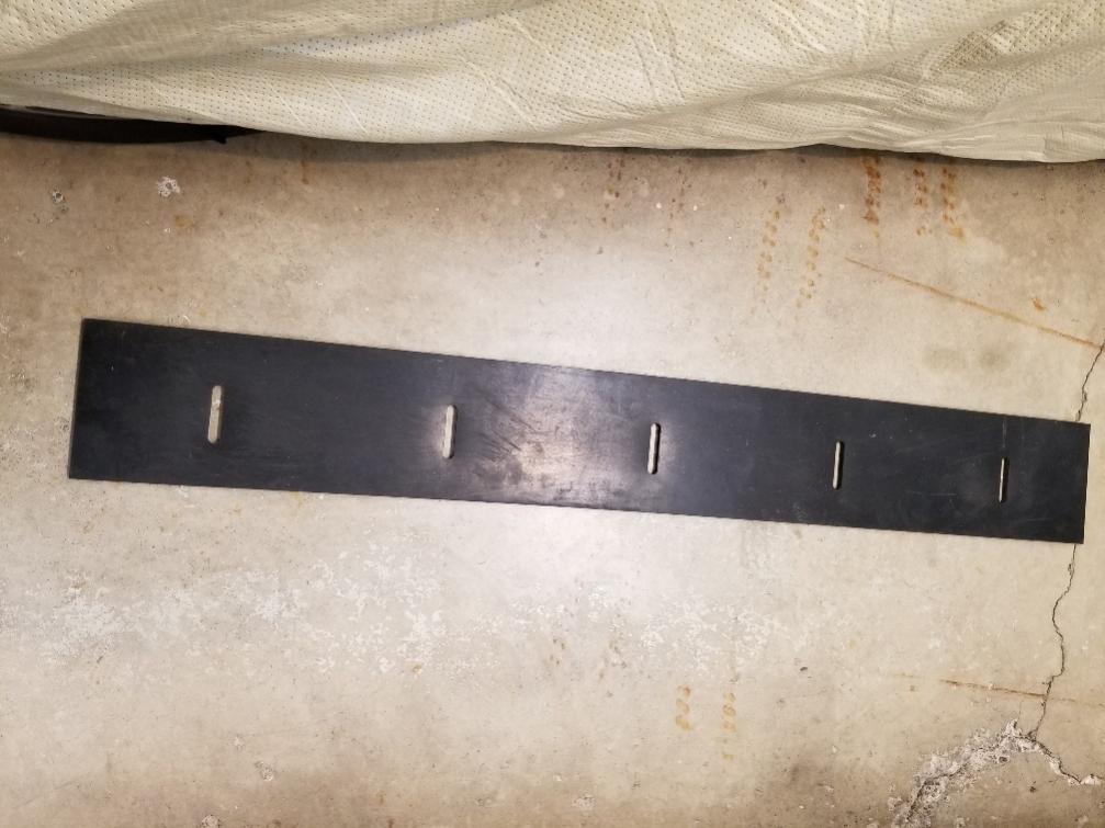

I had a rubber blade made to fit my 60" rear scraper. $40.00 Canadian Dollars.
Best regards, Les.

Hi Nojacketrequired.
I had it made at Canada Rubber in Bowmanville Ontario. I live about an hour east of Toronto.
Canada Rubber will make you anything you want. I dropped by their office and they had a sample of what they make for commercial plows, which was way over kill for my application. They just asked me for details of what I wanted, then they had their team draw up schematics of the proposal. I signed off and it was ready a day or two later. I picked it up, but they ship as well.
I spoke with Wayne and he was extremely helpful. Couldn't have been easier.
Let me know if you need anything else.
Les.
