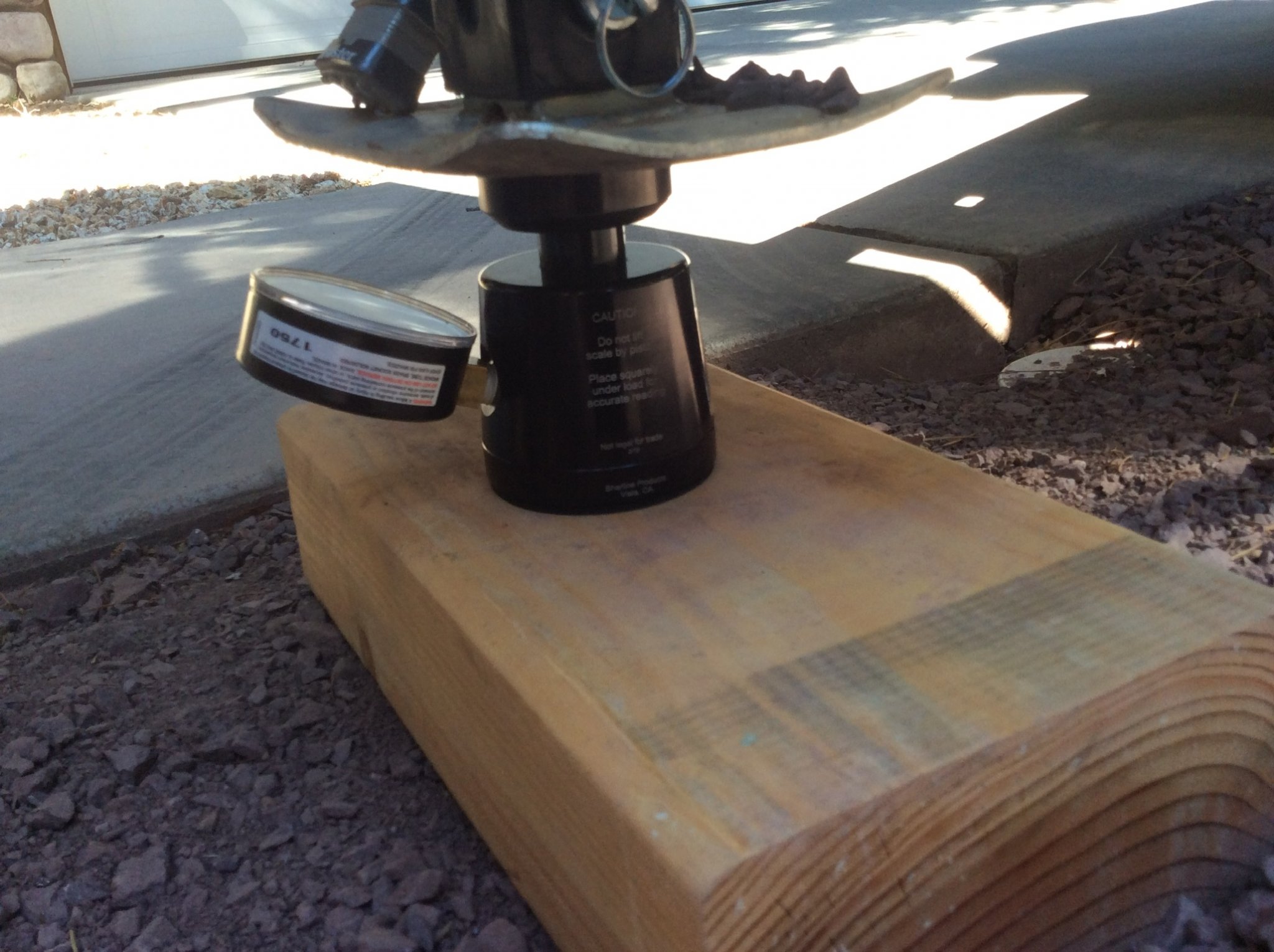

I know the weight of the trailer and the tractor weight giving me the total. I then use my scale and move the load to get 12.5% of the total. A cheaper way is to use a bathroom scale and some materials to create your own. homemade Quarries, feed mills, landfills and truck stops have scales if you want to do it that way.

Cool. Thanks for the links, particularly for the link to the Sherline scale ... I can see one of those in my immediate future.
I used this one to set my rig up…works great. I figured out the ideal set up for my trailers…much safer way to tow.
