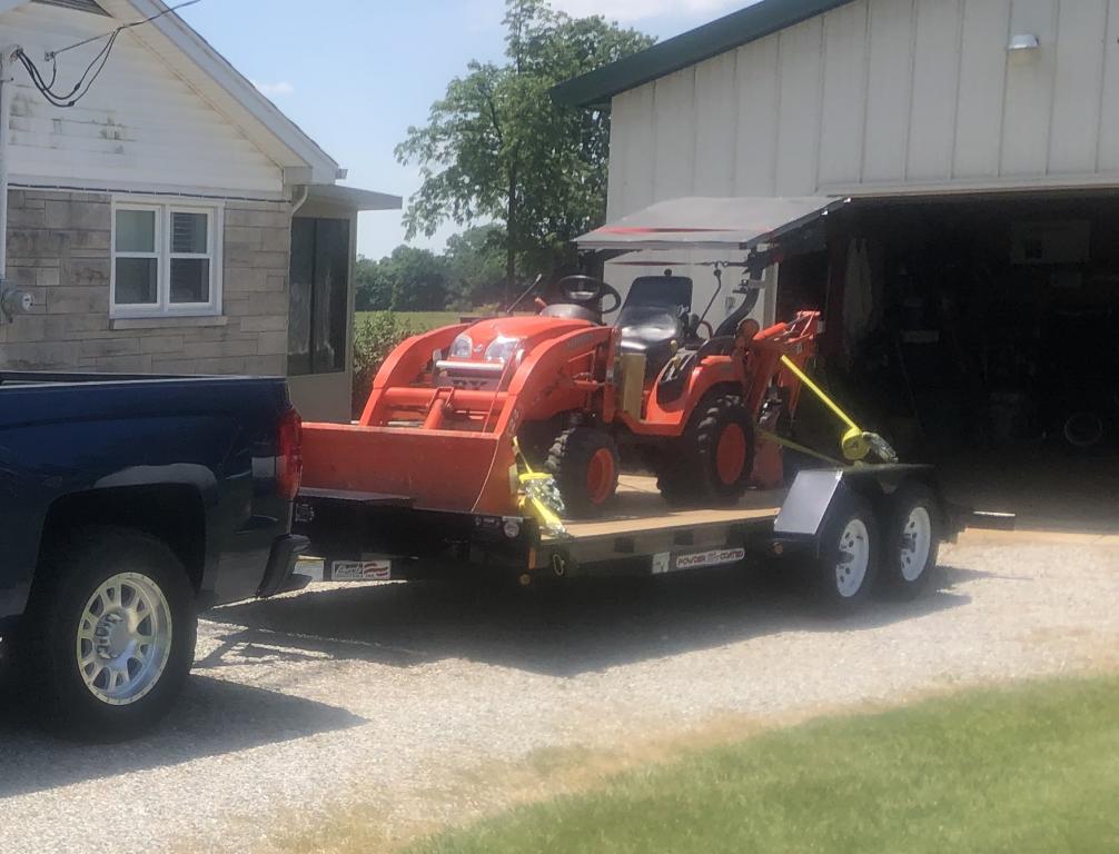

BX24 on an 18ft Liberty 7,000 lb car hauler. Ramps slide in the side and I have wood blocks I put under the back of the trailer when loading the tractor. I looked at several different brands of trailers and picked the Liberty because it has brakes on both axles and the ramps are stamped steel opposed to the angle iron ramps most trailers have.

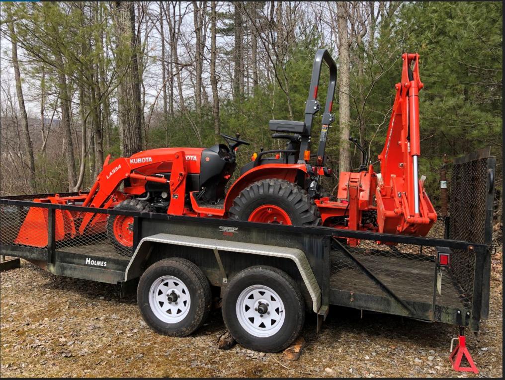

B2650 on 16 foot Holmes landscape trailer. This is the trailer I used for part time landscaping business when I had my old BX23.
I'd like to upgrade the trailer to an 18 foot aluminum flat deck trailer with a dovetail and stake pockets.

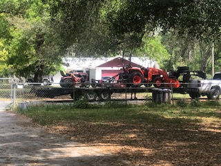

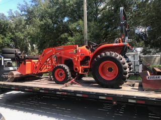

Big Tex trailer 30 foot 14,500 gvw.
L2501 with a 14 foot hayride wagon
L2501 with a roller and box blade
L2501 and 312 Wheelhorse
I hate the Big Tex but it will work for now.

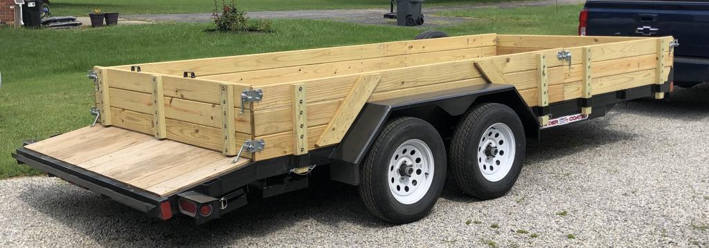

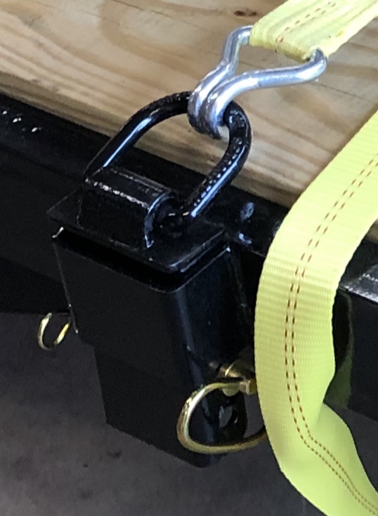

I went with the car hauler since there are no side rails to interfere with side loading. Fold up ramps interfere with loading pallets from the rear with a forklift unless there is enough room between them. I built removable sides for hauling loose materials. Stake pocket mounted D-rings work better for hooking tie downs to than hooking them under the stake pockets.

Looks really nice, I had thoughts of doing something similar to get more use out the trailer besides hauling the tractor.
