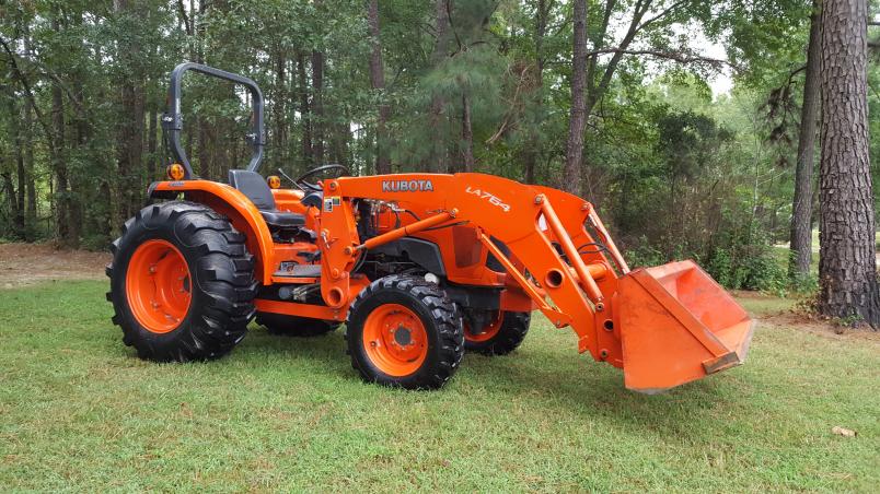

OCD, yep that would be me and Katie Kubota gets a bath on a regular basis.
I wipe her down when she gets dusty and use spray on wax each time after getting dust off. She gets a real wax job in the spring and in the fall before winter roles in.

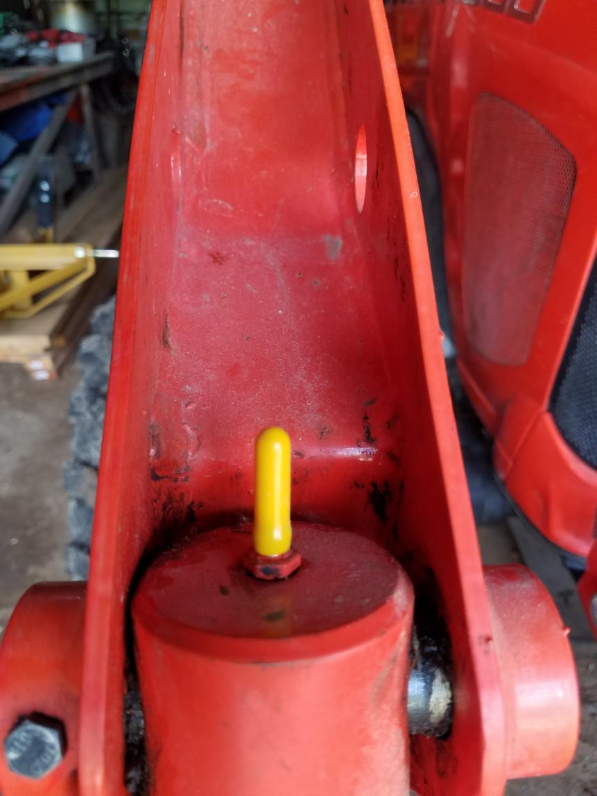

I keep covers on the zerks and use various means to keep grease off the areas around the zerks; q-tips, rags, small spatula used in labs that has a 1/2 wide blade which does a great job scooping it up.
In fact the tractor gets washed more than the Tundra or either Highlander.
I have no intentions of getting rid of Katie but I do feel it is important to keep her looking new. She is now 6 years old and just rolled over 250 hrs.
