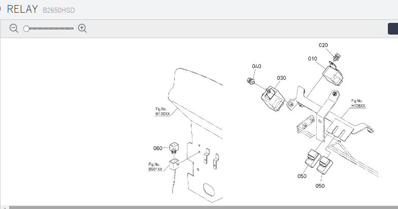

Cool, but I'm assuming there's more than one? There's one on what I would call the fire wall. But from what I have seen there are more under the dash panel. I was hoping for a detailed location?
If not I can do the elimination process.

I can't find a designation as to which relay it is, look at wire colors.

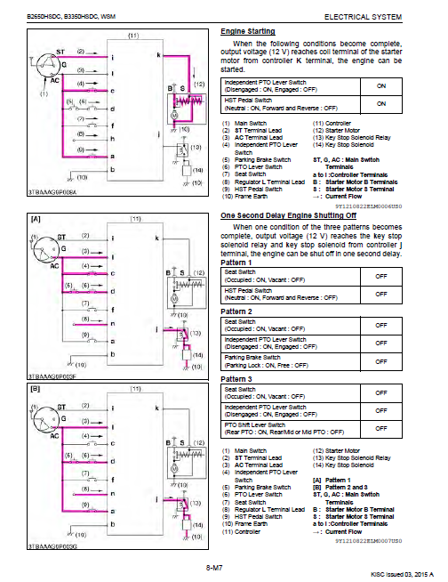

I'm going by what the WSM states.
I've given you those pages.
Normally run solenoids have 2 wires one for pull in and one for hold.
Your solenoid has one wire (white) for both pull in and hold.
That would tell me its only powered part of the time.
But It wouldn't be the first time I was wrong on how Kubota is running it.

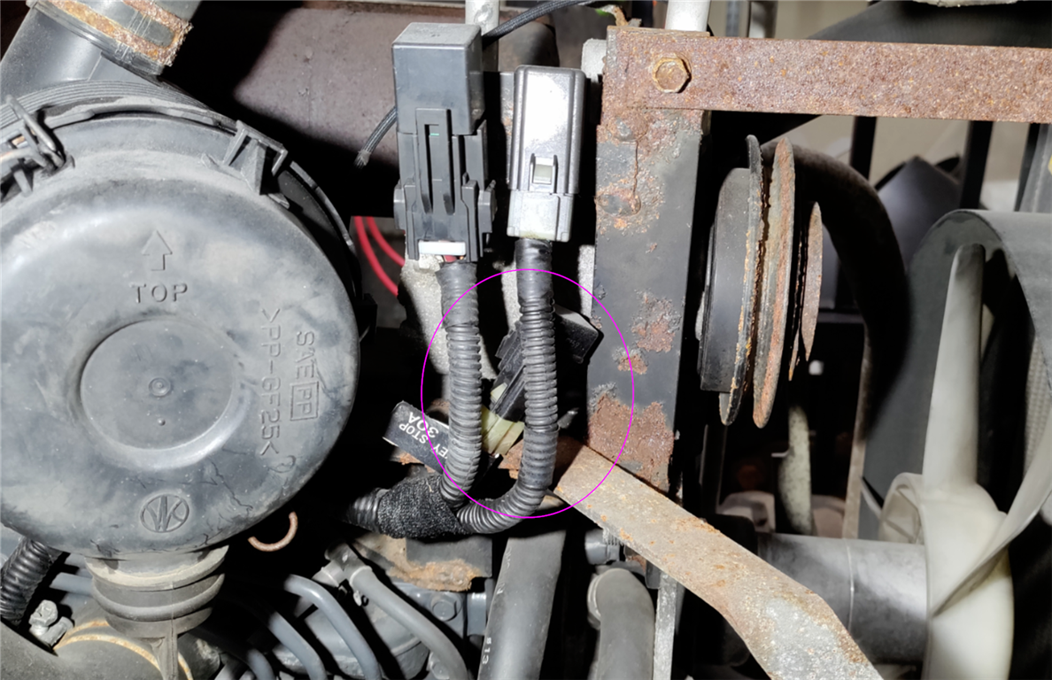

In my case where my engine would not start, it was a corroded wire leading into the 30A fuse holder for the key stop solenoid. I had no power on either side of the fuse when I tested it. The supply wire simply fell out of the crimp terminal. I had to open up the loom and keep cutting back the wire until I had clean copper again.
The key stop solenoid relay is right above the 30A fuse holder.

For a number of reasons I encourage you to see the troubleshooting process through before throwing a relay at it.
#1. It will be educational and what you learn will directly relate to troubleshooting any electrical problem you have in the future.
#2. You will have to look long and far before finding another teacher with equal patience and knowledge to Wolf"s.
#3. It's the least one should do if someone takes time to look up and post information then show willingness to walk them through it.
#4. It helps set a badly needed president that can take OTT to the next level.
#5 You walk away with a bit of pride in saving several hundred $ with a small investment in time and parts.
#6. The problem doesn't necessarily have to ly with the relay, reading what wolf highlighted from WSM tells us it can be the seat safety. Winding up with a spare relay doesn't help the objective in #5.;)
On to the technical chore. Alligator clips on your meter leads are like extra hands that allow you to use and watch meter while hands mess with things or siting at operator's station so that all safeties are satisfied. Which brings us to putting meter across power in and power out terminals of relay to see if contacts are welded together and/or if signal wire is telling relay to close 100% of time rather than momentarily as ignition is turned off. A bum seat switch would do that. I THINK but not positive that relay has built-in delayed action which would be good to know while testing ( I defer to Wolf as to whether that's correct). The delay/momentary feature could trick you into thinking solenoid isn't getting power. With Wolf's diagrams and a little help you can nail the fault down. Just walk away if you feel like giving up or throwing something then come back after your head is clear.
