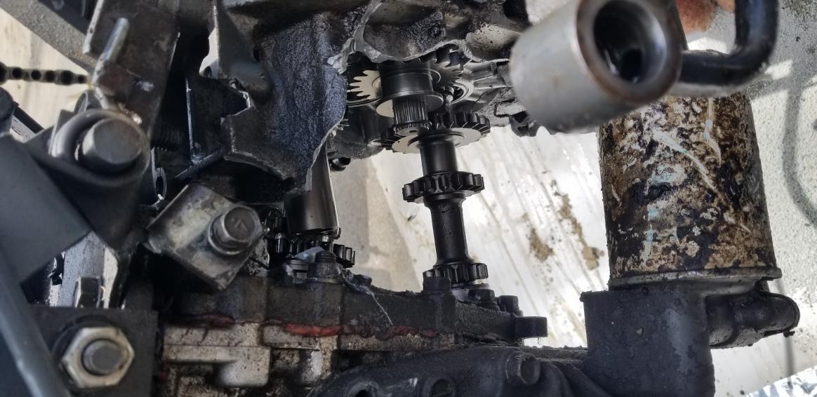

When I connected the tractor back together I made sure the two drive shafts hit their mark. However, I separated the two in half a second time and I failed to verify the shafts were correct.
Front wheels were blocked and I had the back off the ground, everything turned fine so I thought???

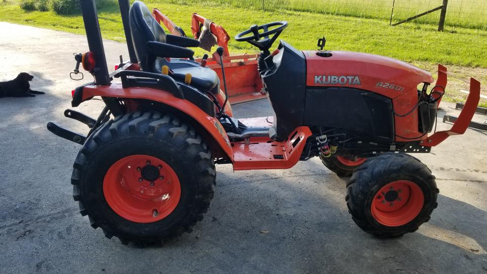

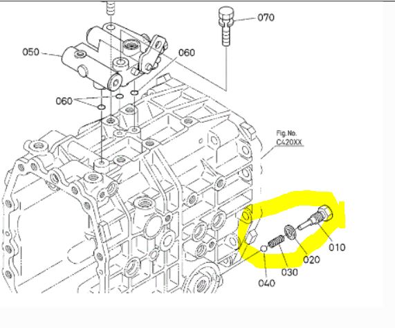

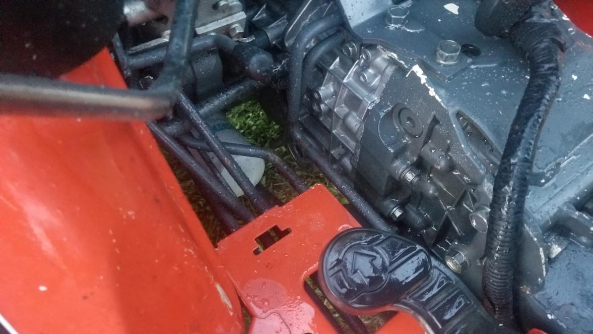

Put the hydraulics system back together and all I am lacking is the bolt, spring and ball pictured in the 2nd picture.
I'm not sure why it is there, must be a check valve but it pisses fluid when I cranked her up. I made a bolt on my lathe and bought a spring, had the ball bearing all ready. Its not right because it is still pissing fluid. just a steady stream.

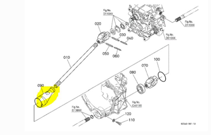

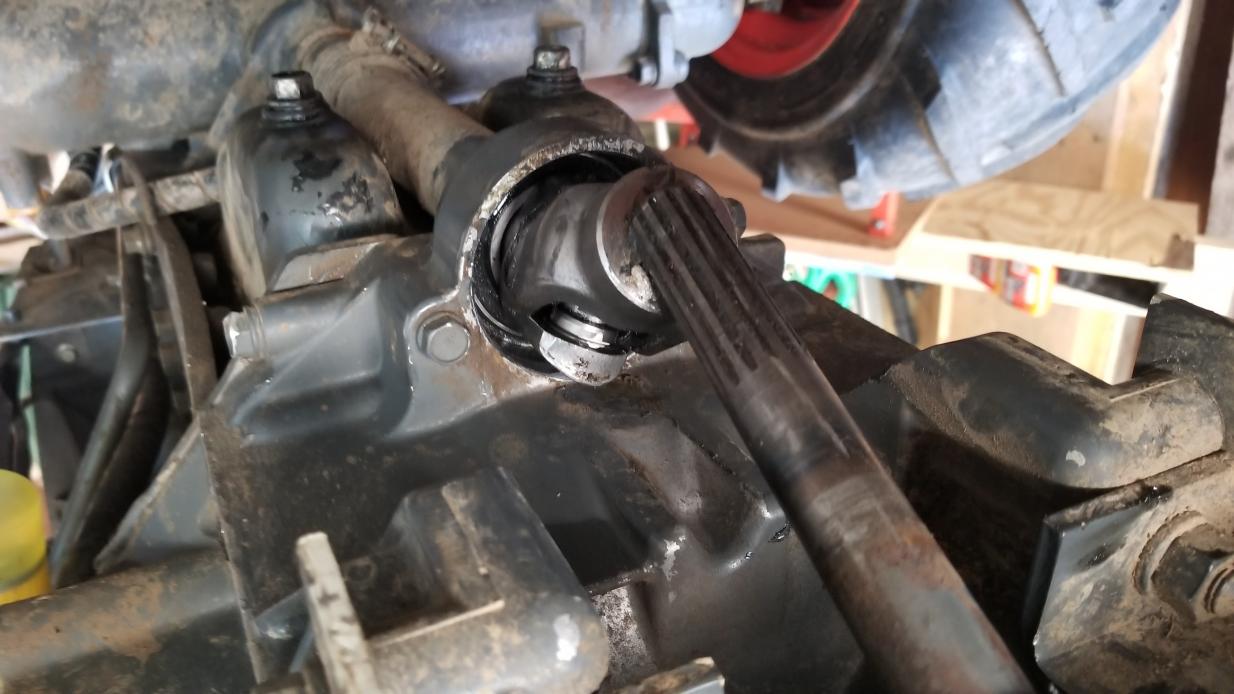

Got underneath and noticed a budge in the cover over the universal joint for the shaft to front axle. OH NO I said! Ok I said some other things and threw the hammer. When I slid it together the second time it missed the universal and slid to the side of it jamming the universal so the front wheels would not turn.
The only was to fix it was to break it in half again!
I cut the cover off and was able to use two tie down straps from the front wheels to the rear wheels to hold it together. I had to unhook several things and remove the floor sheet metal, brake rods, hydraulic lines, and lots of bolts!
Was able to line it up and used the straps to ratchet it back together a click at a time adjusting up and down with jack.

She works, all 3 ranges, just need the parts for the check valve to seal the system! I'm tired! :eek:

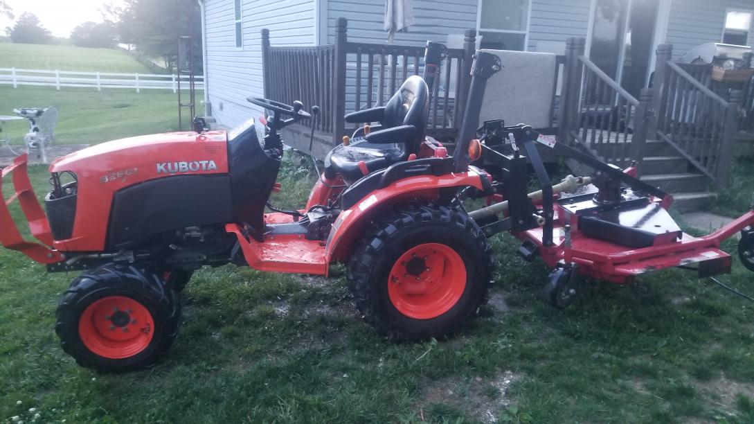

I hooked up the finish mower and cut the edge of my hay fields with her. She functions as she should. I might have a noise in my PTO, waiting to get a better listen. Need some front weights with that loader missing.

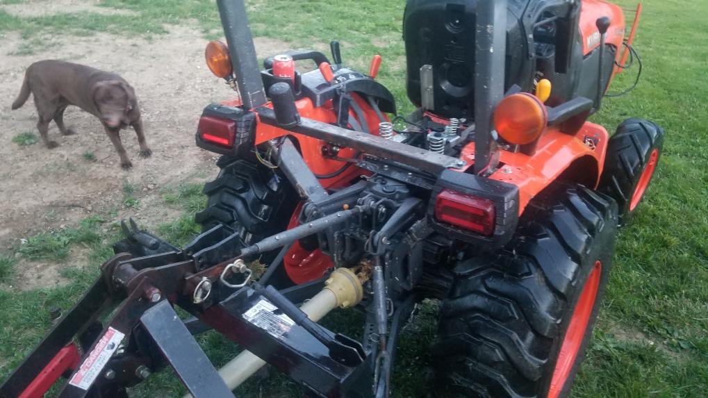

20180525_185215_001.jpg Still have several things to install. Need to get my lights back installed and some of the covers on the flooring panels. :)
20180525_210416.jpg You can see the new case in this photo!
