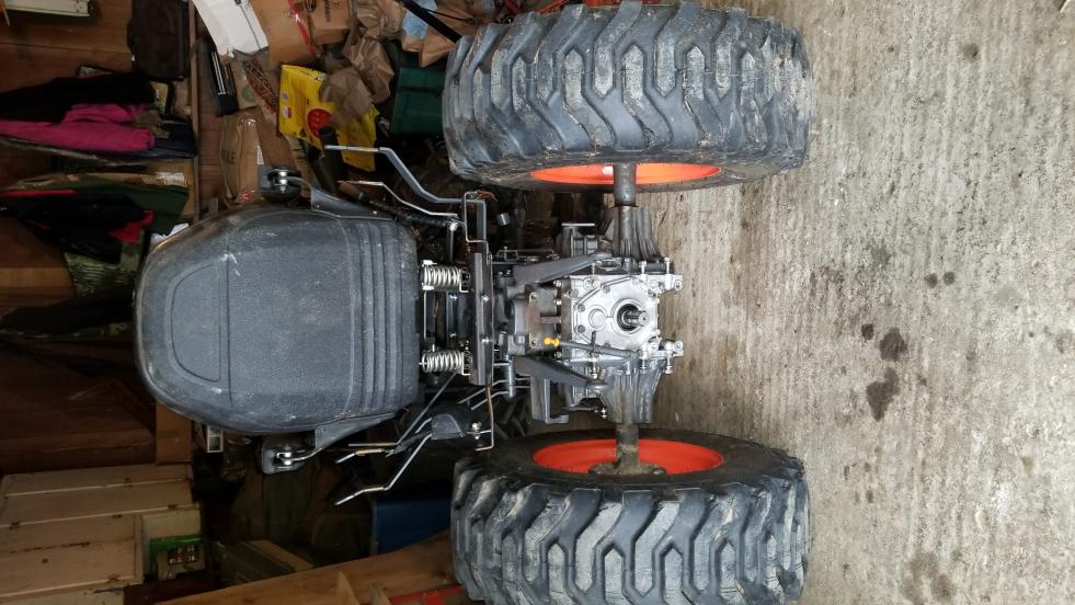

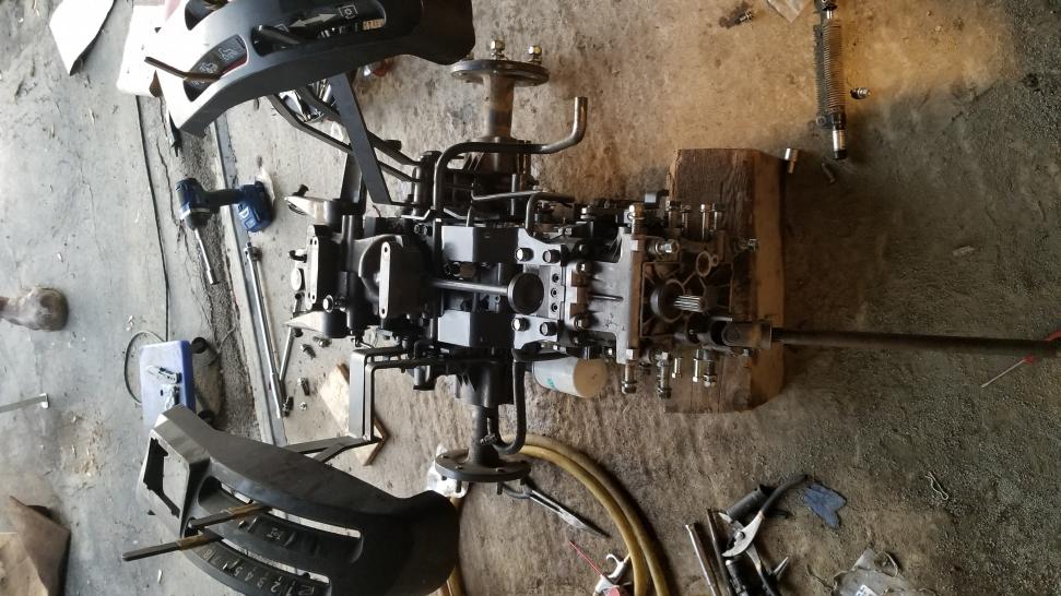

Well, a productive day. I have the HST rebuilt and ops check good. Little heavy but it's possible. Tomorrow I will get the rear end on my floor jack and strap it on. Then I will be ready to bring the back and front back together. I plan on changing all the filters after the first hour or so, still a lot of crap floating around in the cases. To this point, there were no special tools required.

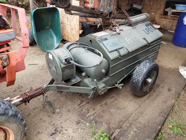

I did not see anyone answer what that machine is. Please enlighten me. To me it looks like a giant air compressor on wheels.
An ex USAF MC-2A rotary air compressor to be exact, 15 CFM at 200 PSI :eek:,
This fine gem was used probably used in the motor pool. :D
It was a gift from a friend, I'm just working on it now, hope to get it up and running as it will make a really fine field work compressor.

Thanks Wolfman! Since that is on wheels I would think it would have seen more use on the flightline than in the motor pool. It is a cool thing to have anyway. I hope you get it working again.

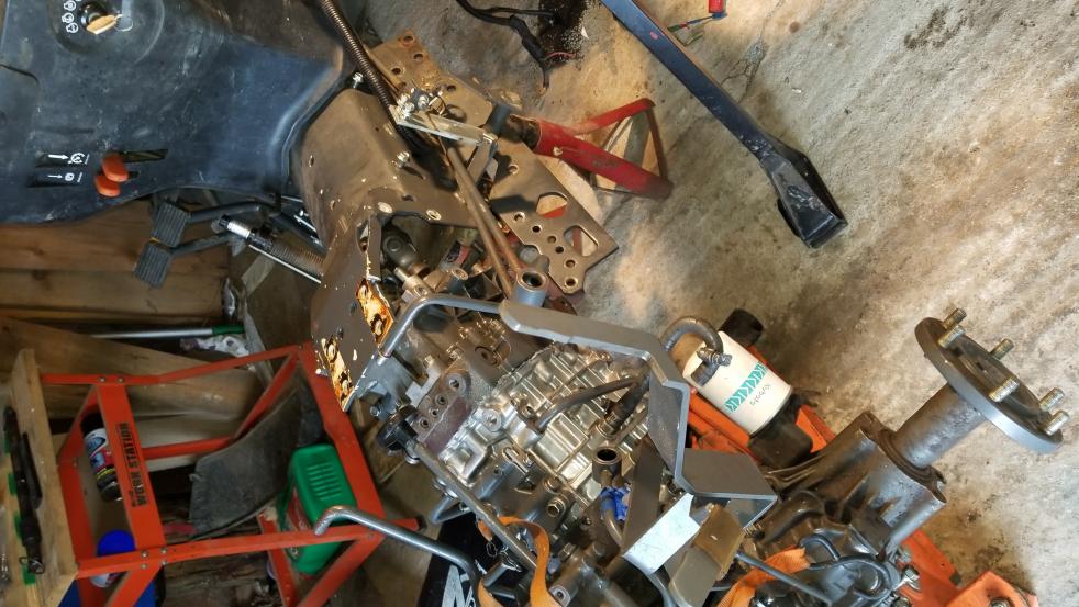

Was able to focus some time on my girl this week. Made great head way, still need to install the Loader valve and complete the hydraulic system. Need a oil drain bolt that was lost in the crash I forgot to order. HST filter was picked up by Wrecker folks, not sure what happened to it. That piece of the Housing had the bolt in it.
Don't ever say never! Might be able to get a Job at Kubota Now! Use this rebuild as my resume LOL.

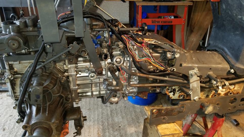

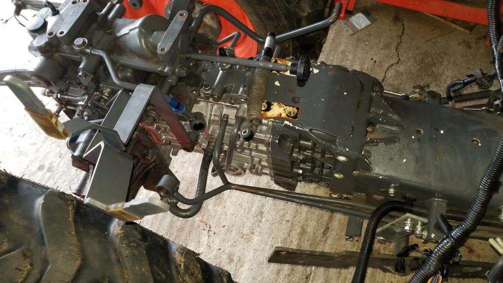

I did hand crank the motor, turned easy, checked cylinders' for oil, none present so I fired her up. Started fine, was some smoke initially, then normal. It did push some Hydraulic fluid out of the missing drain plug from the front axle I would guess.
I found the wire harness was almost cut in half in the roll over. Repaired it, still need to wrap it up. PTO shut off is functioning as it should. Stall need to solve the ROPS and Loader issues.
3-Point needs the lower ROPS installed as a minimum! Loader is the last thing to worry about. If I can't straighten it due to thickness I can always cut it and weld it back in the shape I want while keeping the ability to raise and lower it.
