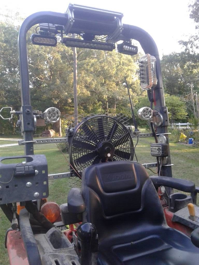

I'm sure many have already done so. I plan to add a light bar under my ROPS. I've got the parts it's just a matter of taking the time.

I changed all my filament bulbs over to LED on both my M's with the exception of the turn signals and hazard flashers. LED bulbs and conventional flasher relays don't get along well.

I mounted a set to the front brush guard.
I had a thread on it a while back.
