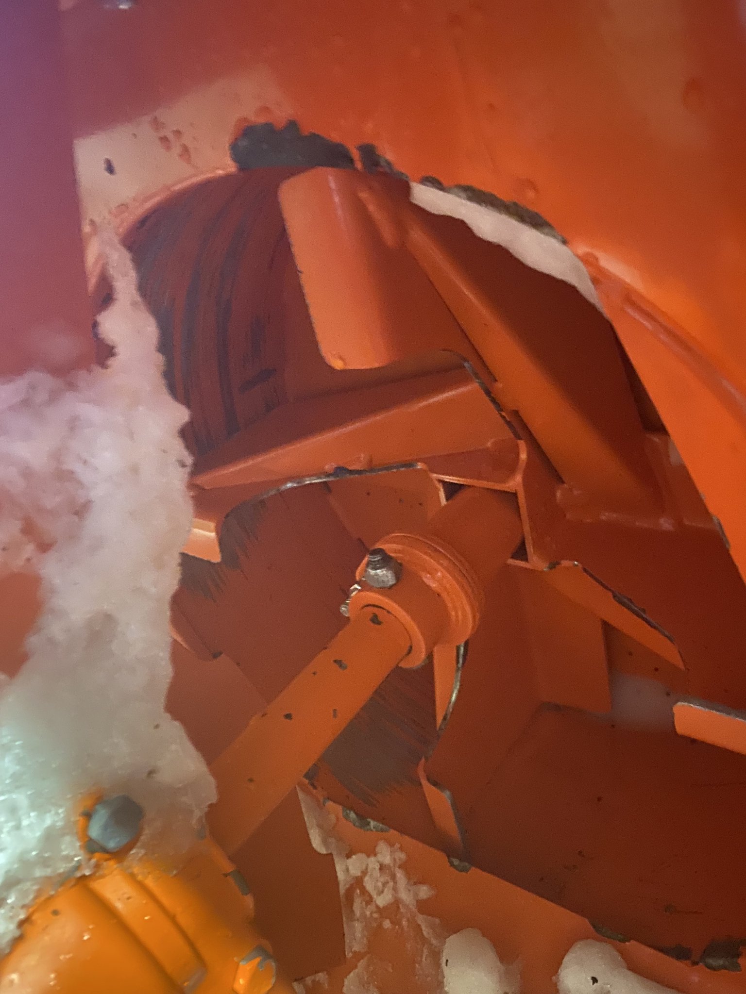

As my title states I am having some kind of grinding noise issue when I engage the auger. The internal auger that blows the snow looks to be getting gouged from something but can't seem to figure out what's causing it.
I had to replace a shear pin today but can't imagine that being the cause. Any ideas or maybe someone else has run into this I would be grateful for your help.

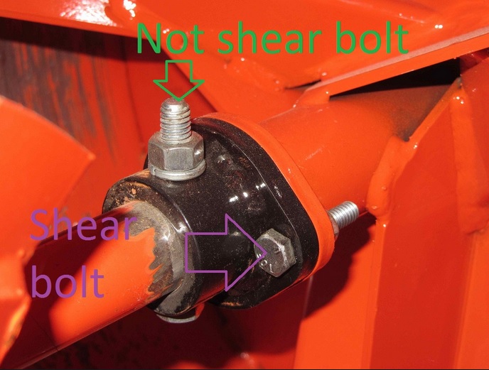

To be clear when you say "internal auger," could you be meaning the fan which throws the snow out the chute?
There are two different shear bolts on your style of blower. One for each half of the auger and one for the fan. Which one failed?
Posting a couple of photos might help someone see what you are hearing.

We need to clarify which bolt sheared.
From the position of your fan, I cannot be certain but if you study this photo you should recognize if your setup is this style.
Do you have the bolts identified by the purple and the green arrow?
The green bolt goes through the round shaft.
The purple bolt goes through the flange and is parallel to and beside the round shaft.
If yes, which one sheared?

Dave, the bolt that sheared would be the "Purple" one.

I can see where it is rubbing between 9 and 12 o'clock in the picture that you posted. Something is clearly out of alignment since there is no paint loss anywhere else in that area. Take the long bolt out of the rear vertical cover that makes a 90-degree bend at the top, and has a 1/2" hole in it at the top, and see if there are any bolts loose in the bearing that holds that shaft. The shaft that I am referring to has what looks like a bicycle sprocket on it and the chain that drives it connects to a lower sprocket, which connects to the tractor. I don't have a diagram of your blower, so I can't identify the parts by number. Most likely the bearing that holds that shaft has shifted. You might have to remove the chain and sprocket to see it since it is a very close fit in there. I have your snow blowers big brother and have had him apart to fix this problem a long time ago when I picked up a large rock and damaged the fan. Not a difficult job and doesn't require any special tools. Just a greasy job, and difficult if you have to work out in the cold. In a warm garage, it is easy. Even easier if you can get it up high enough that you aren't on your knees doing the job.

The fan blade on the far right seems to be bent outwards. I had that happen once when I caught a rock, bend the fan blade right out until it hit the housing shroud.
Bending the blade back fixed it, for now.
