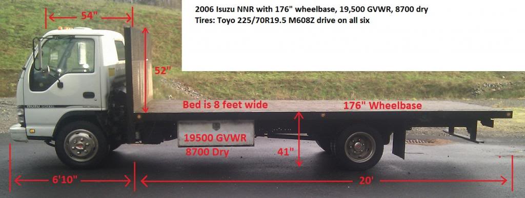

I am torn what to get. I need to put it on our Isuzu NRR 20 foot flatbed, which weighs 8600 pounds and has a GVWR of 19,500. The U25 would easily fit, the U35 *might* be ok.

I need to fit the excavator on this 2006 Isuzu NRR flatbed truck which is 20 feet long flatbed, 176" wheelbase and can carry about 10,000 pounds if properly distributed. The problem is if I use ramps, the 8200 pound U35 potentially could lift the front of the truck off the ground (I did the math). I could put wood blocks or jacks under the rear of the flatbed while loading...

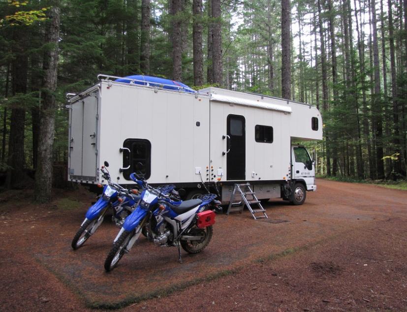

The Isuzu NRR will shrug off the weight of the U25S since it carries our homebuilt camper pods which are near 10,000 pounds.
