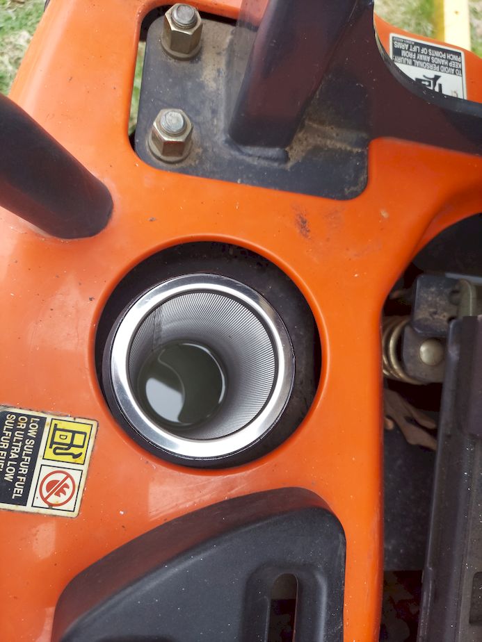

I just got mine. I took one look at it and decided it was not going to fit.
Then I took it out to the tractor and it dropped in like it was made for it. :D
I did not use the gasket. I don't see any need for it. The cap screwed down normally.
Good to go! Glad I saw this thread!
This is the one I got. $13.99
Whoops. I meant to add a pictoor. Here it am.

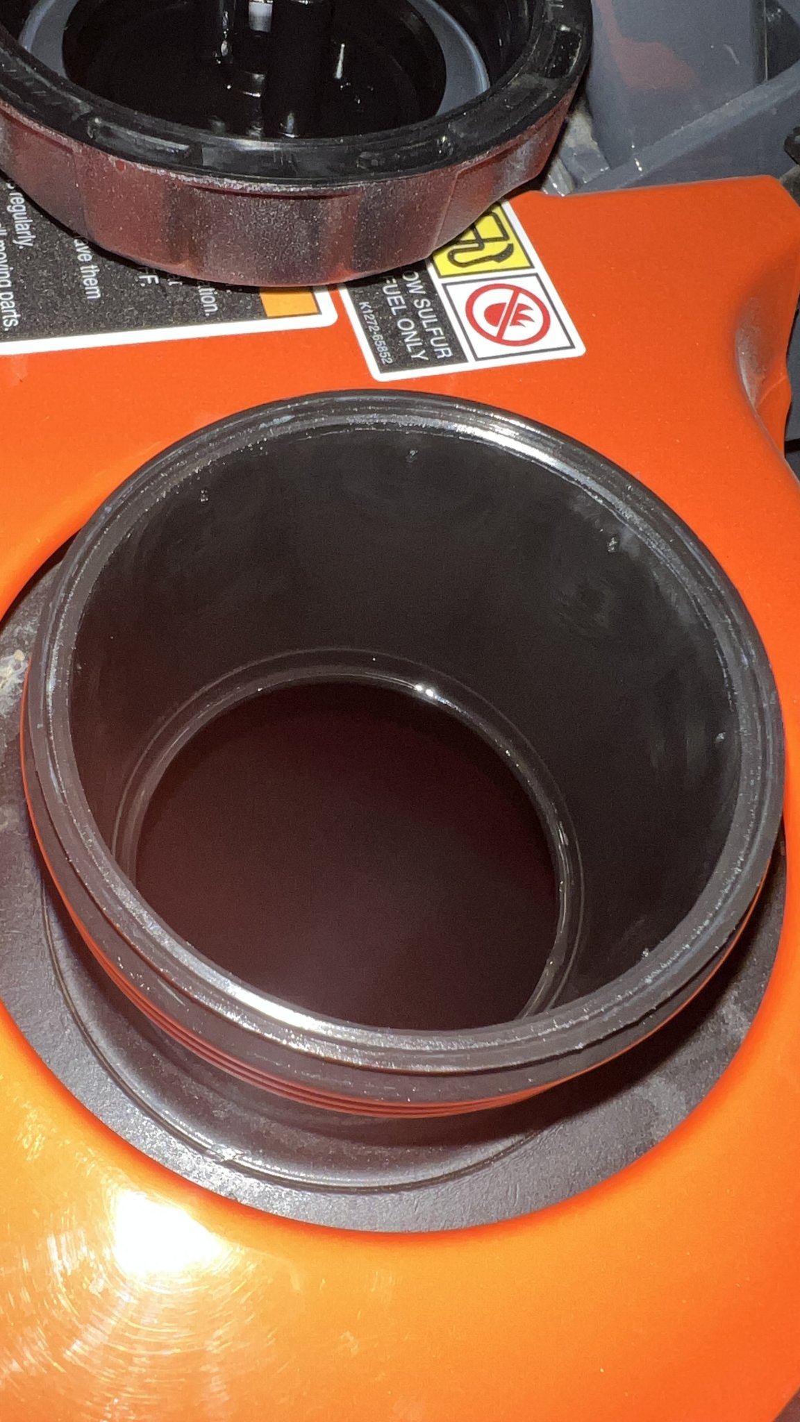

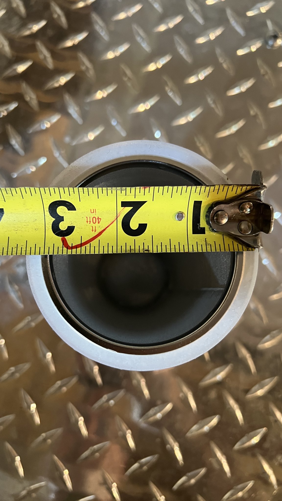

I purchased this one for my 2680 and it did not fit due to tank neck having a flange, only about a 1/16" all the way around but enough to keep from fitting. That's how tight it was. Sure I could have forced it but that would only create more problems down the road. This is the no fit for 80 series..
It's not tapered at all which would be better for quicker fueling But was reason for not fitting. D62B69B7-B49C-4257-8F8E-F935E4F32C1B.jpeg 45CC7118-9672-4B8D-90E4-9B8EB53FA96B.jpeg

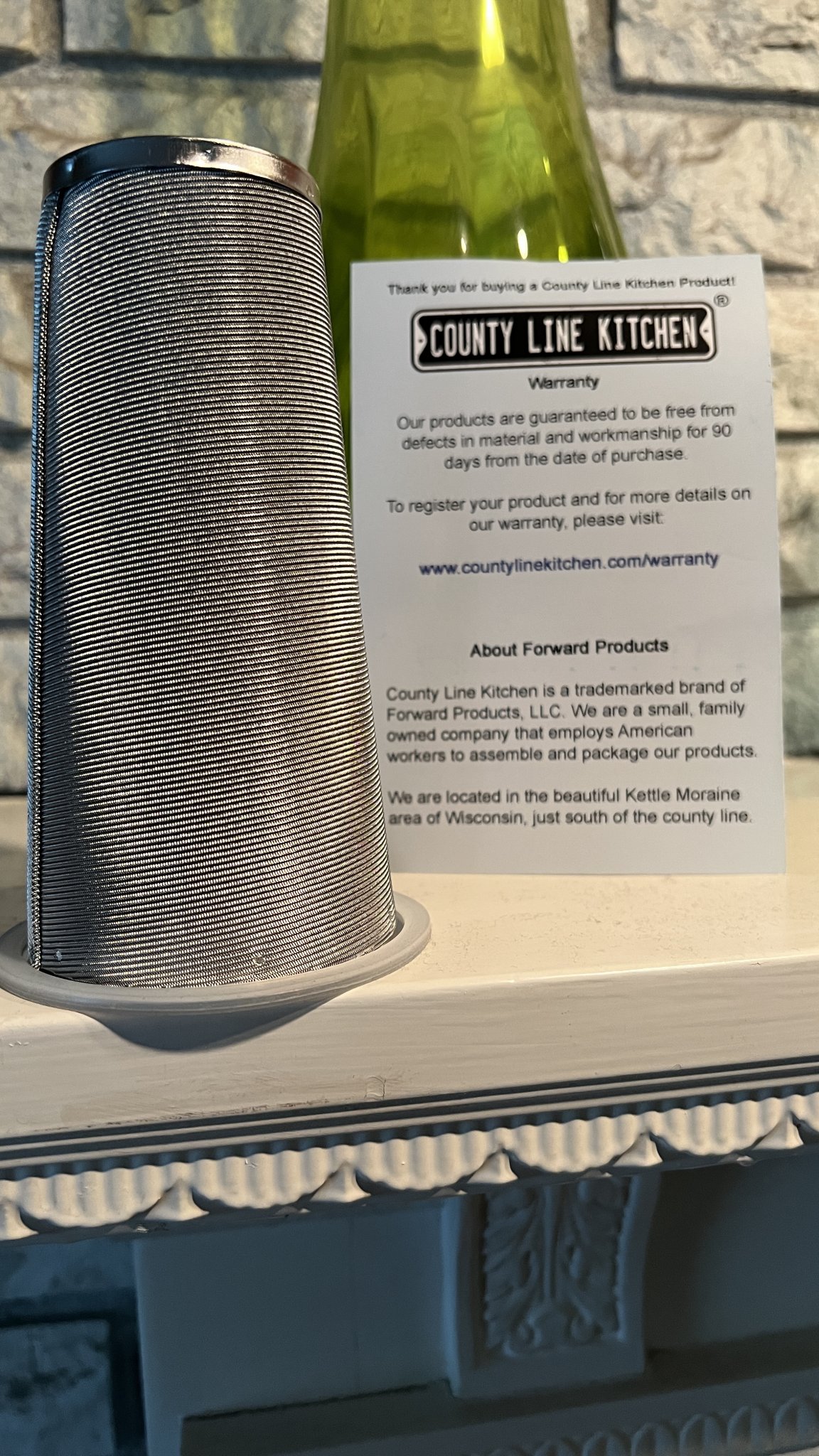

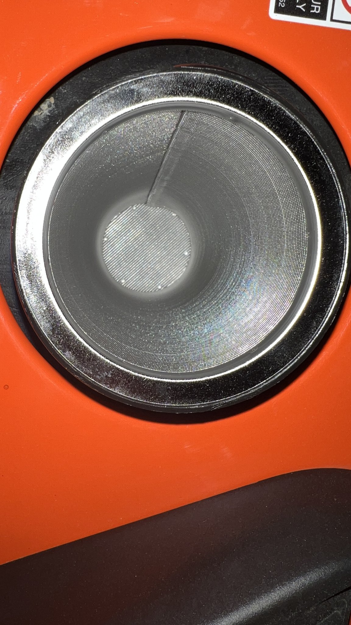

I purchased this one and got it right.. has a significant taper.. hopefully it doesn't slow fueling process too much.
This is a go and came from Amazon also.
I got another better pic of the flange I was talking about a few inches down.
