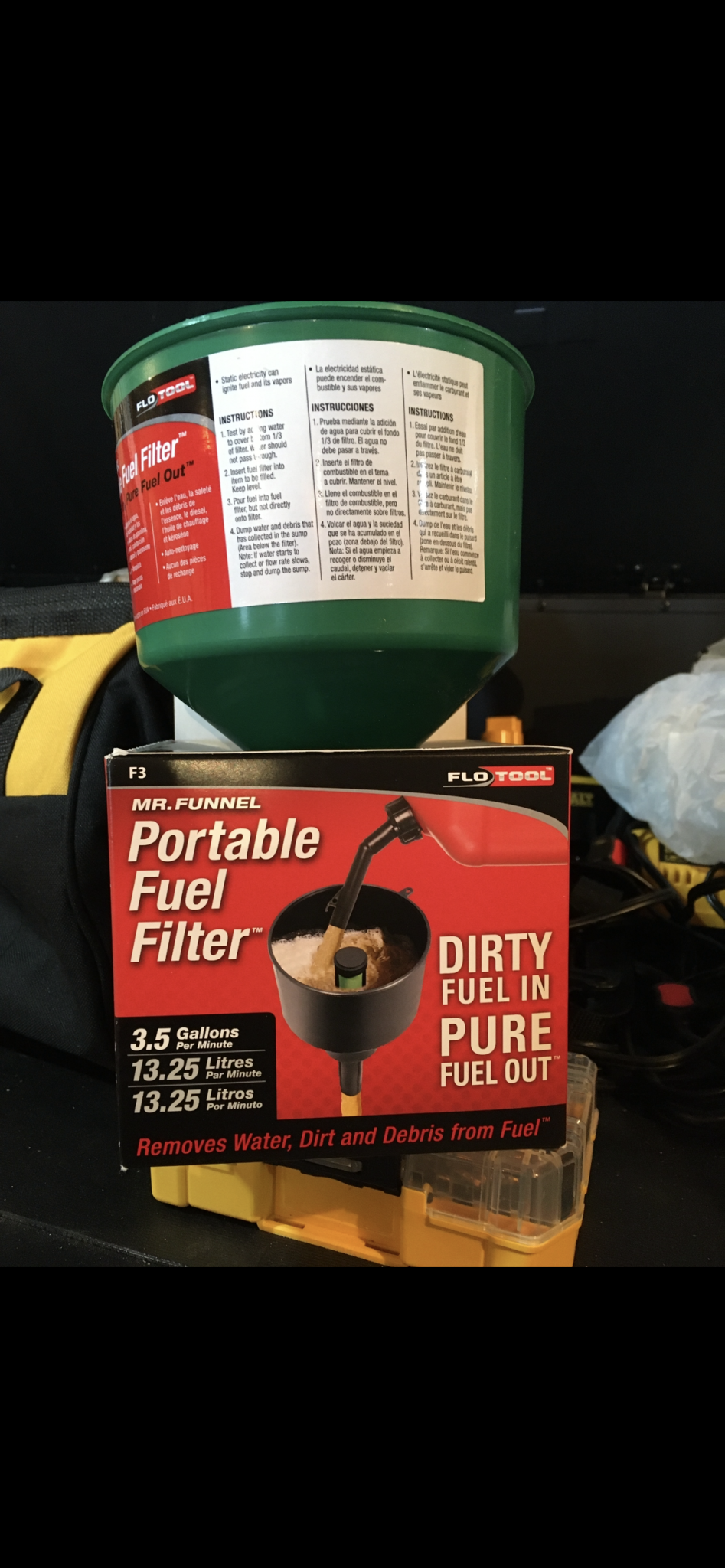

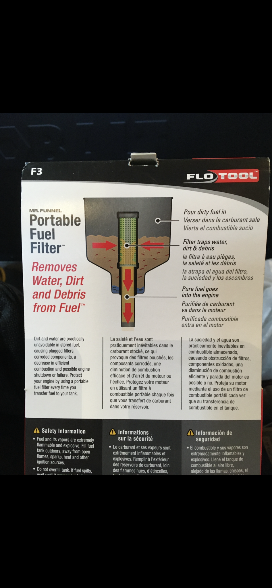

I don't understand why you don't just use a "Mr. Funnel" filter? It will remove any water in the fuel as well.
I use them for the tractor as well as all of my mowers. Yes, there will be a small amount of fuel left in the funnel, which I use for some driveway weed "control".
I picked this up not long after I got my tractor. It was on clearance for $5 so I figured what the heck, I use it and as said the little bit of fuel left in bottom kills the weeds in the drive.
I would still like to get a screen though.. just in case!

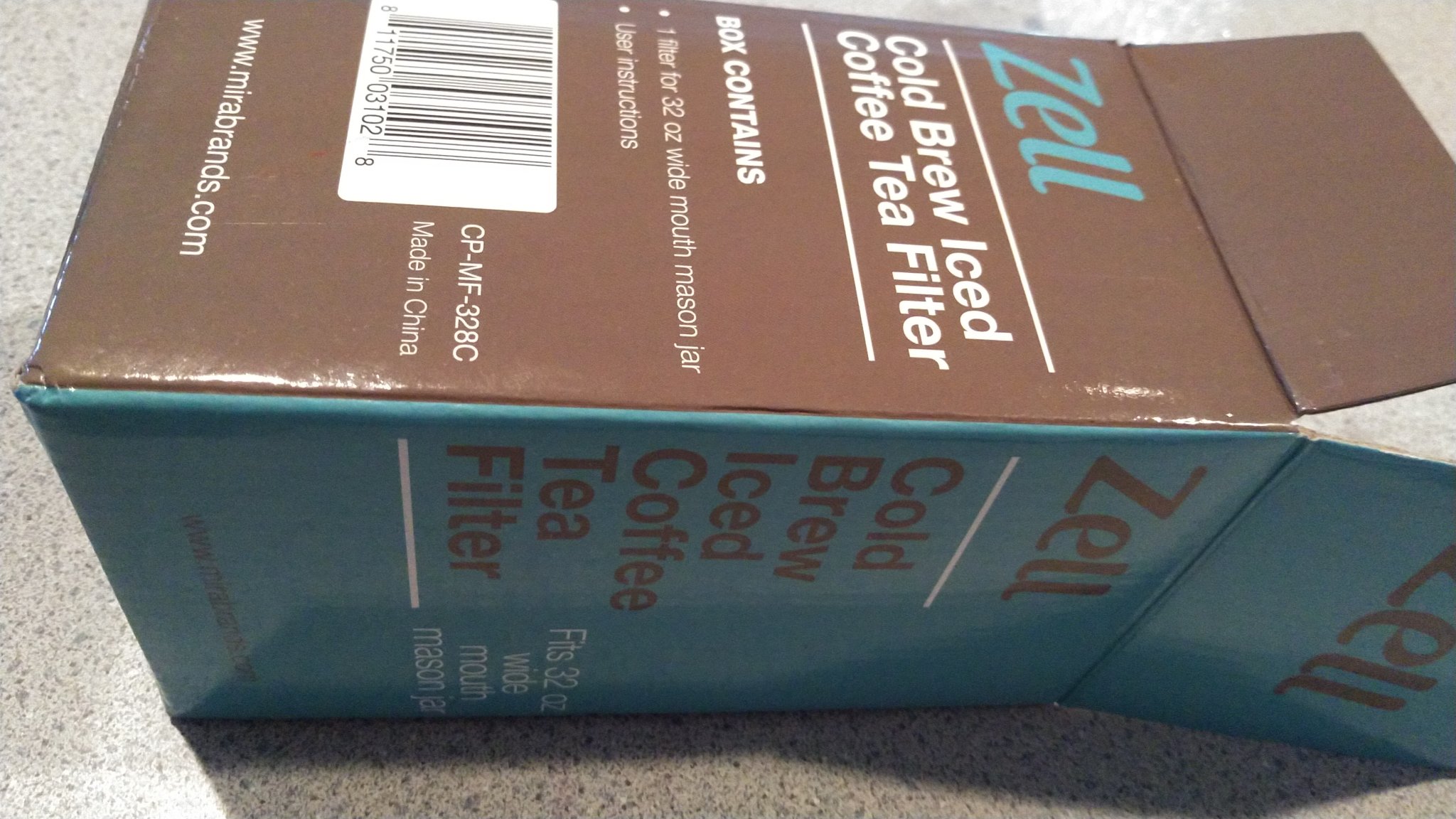

Well, it just arrived and the fit is perfect, no extra gasket needed, it sits slightly below and inside the ridge that seals against the cap. It is also loose inside, easy to remove.

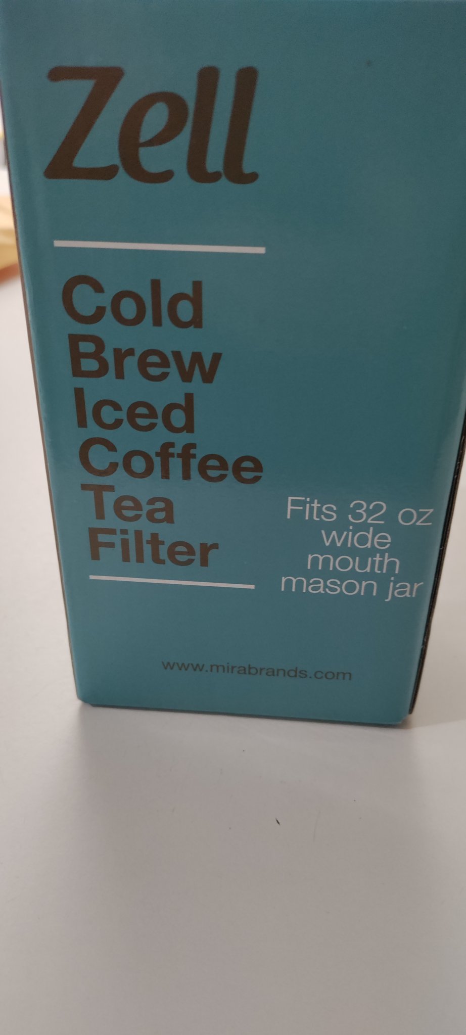

Greetings,
I have found a perfect fit, drop in screen for the BX23S fuel tank. It is a Zell cold brew iced coffee tea filter for 32oz wide mouth mason jars.
Thank you, Hornet.
I got mine the other day and it fits great on my BX23s
no problem filling with my HF electric pump setup.

Well I just got my Zell coffee filter!
SOooo I wonder what happens to this stainless basket after soaking for a while in a tank of diesel?
I will be periodically checking it to see just how good the stainless is! First sign of color change or oxidation and its gone! All stainless is not the same!
EDIT
I gave it the magnet test and it is good quality stainless steel like used in the food industry!

Confirmed, this filter fits perfectly into a 2020 BX23S with no mods.
Purchased on Amazon for whatever I said above, $15 iirc.

I don't plan on leaving mine in for this exact concern, only going to put it in when I fuel up.
