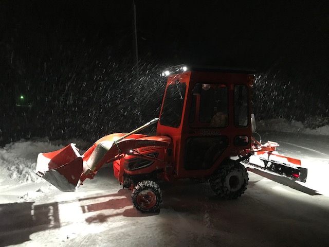

First off, AWESOME build and I will absolutely be using your experience when I build my own! You say it's far from perfect, but it's a hell of a lot closer than most any other DIY cab builds I've seen!
I'm curious, have you run this in cold weather yet? And if so how is the fogging/icing of the glass? I assume I'll need a heater and ducting to the glass when I build mine... but maybe not?
I'll be snowplowing in anything from 0C to -20C so the least bit of moisture will fog/ice up windows in a heartbeat.
Also, did you mention cost? If you don't want to, that's fine. I'm mostly curious about the glass since I'm assuming that was the most expensive part.
DanR,
Thanks. Im happy with how it turned out. No way was I going to throw together something that looked like a Red Green Handyman project! I sure miss that show. In my mind, Perfect = 0 defects! For one, I really need to improve on my body work skills. Good thing that's not my day job!
I have less than 2 hours run time with the cab on. Outside temps in the low to mid 40's (F). I didn't notice any issues with fogging of the windows. However, I have not yet installed any form of auxiliary heat other than my fat behind!. I do have a fan to blow across the windshield and left both front and rear windows operational to allow even more fresh air in. I've tried to seal up the exterior gaps between the tractor and cab but, haven't done a lot with all the interior penetrations other than throwing a couple old bath towels under the seat. All the floorpan holes for hydrostat peddle, etc are still wide open. I plan to run this winter without aux heat and see how things go. At least, I***8217;ll be out of the wind. If the windows fog up too bad or decide I really need to be plowing in shirt sleeves, I'll add a heater next year.
Because I intend to remove the cab during the late spring, summer, fall time of the year, I haven't yet come up with an easy solution to install/remove the coolant lines. I know I can remove the bypass hose and install heater lines but, won't that just allow coolant to flow out? After all the level in the radiator is substantially above the bypass hose. What I'm looking for is an easily dis-connectable solution that will be compatible with the antifreeze and not restrict flow too much. I thought about mold coolant quick couplers (similar to air line quick connects) but rated for temp and pressure. Not sure if they have enough flow? I've got all winter to figure this out.
As for cost, no, I never mentioned $. Some of the materials I had laying around. If I had to go out and buy everything, I'm shy of $2k. And, you're right, glass and rubber gasket alone was over 35% of that. It's expensive but, I only have to cry once. I ended up going laminated based on my local glass guy saving me a few dollars over tempered. And, if I break a pane, it'll stay intact or I can use my templates (assuming I can find them) to have a replacement made.
If your BX is an 80 or 60 series an older, the cab doesn't have to be as tall as mine in order to keep the ROPS in place. If I would have chosen to remove the upper portion of mine, I could have shortened the overall height about 6" without limiting level forward visibility if that makes sense. If you were to fix the front windshield and move the wiper to the bottom, you could gain another couple inches. I say that because bigger & taller comes at a price. More steel, more glass, more paint, etc.
Hope this helps and let me know if I can help in any way.

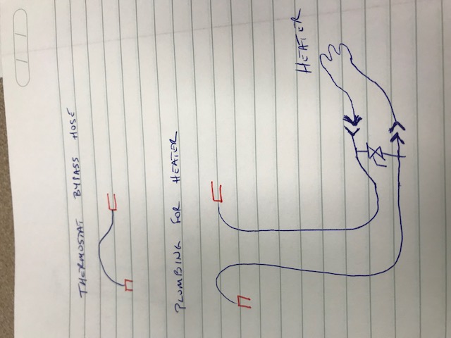

Thanks for the info guys. I'll see how those sizes fit the space I'm thinking of mounting it in. Hopefully one will work, if not, I was originally considering a Maradyne 503012. Only 12,500 BTUs but may work, any concerns?
Do either of you have any experience or thoughts as to the amount of coolant loss if I were to just remove the bypass hose and plumb the heater direct, reversing the process in the spring?

Catch the coolant in a clean bucket and put it back in. Make the bypass hose long enough to have it couple together in a loop outside of the engine compartment, then tuck it in when it's together.
Removing the bypass hose where it's connected on my engine would result inn dumping coolant on the top of the engine. If you do it that way, at least drain the cooling system to get the liquid below the ports you will be opening.

Ping - rather than messing around up in the engine bay at every seasonal change, why not plumb from the thermostat bypass somewhat permanently back to a demarcation point near the front edge of the cab. At that demarcation point install quick-disconnect fittings (if they work for hydraulics they will certainly work for coolant). On the tractor side, install a Tee in the pressure and return hoses, then install a quarter-turn ball valve between them.
In the winter time, coolant flows through the lines, the quick disconnects, the heater core in the tractor, and back to the engine. The quarter-turn ball valve between pressure and return is in the OFF position to allow this to work. The thermostat bypass circuit is now a complete flow circuit through the cab heater core.
When it's summer time, disconnect the cab with the quick disconnects. Since the quick disconnects remove the cab heater core you will now also have removed the complete flow circuit for the thermostat bypass. That's what that quarter-turn ball valve is for - turn the valve to the ON position, thus re-establishing a complete flow circuit for the thermostat bypass.

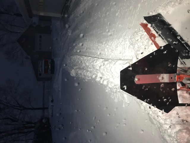

Thanks everyone. My heater planning will continue but, install will likely have to wait until this summer. Boss lady has cracked the whip and I'm back to knocking projects off her list.
I did get about 4 hours of seat time this past weekend. We got 7-8" of heavy wet snow. Temperature was 28-30F. Ran for about 1.5 hours before I started to fog up a bit. Cracked the front window open a bit and problem solved. I'm going to install a heater if for no other reason than keeping the windows clear. I will say it was a blessing being out of the wind. The pair of 18W LEDs front and rear provided plenty of light. And, the backup camera worked well, I just have to get used to it.

You nailed it, Ping. The ball valve preserves the thermostat bypass flow path whenever the cab heater is disconnected. Quick disconnects in the lines should limit fluid loss to almost nothing.

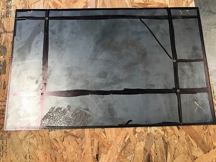

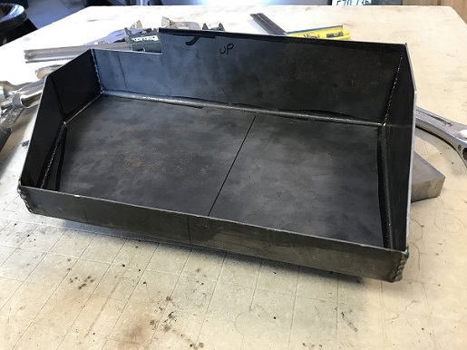

Update: We got another 6 inches or so of dry fluffy stuff last weekend. A lot colder (15-20F) and WINDY! Had no issues with the windows fogging up this time. Boss Lady musta been felling sorry for me when she asked how it was. Told her fine except my feet got really cold. This is when she springs the "well then, why don't you just put your heater in"? So, full steam ahead!
I took the advise of others suggestions and went with a 20k BTU heater. I don't have a lot of room beside the dash and wasn't really keen on locating the heater beside or behind the seat as it would block visibility so, I started mocking up the different models I had been looking at to set the fitment in the cab. I ended up with a Northern Radiator AH454 which appeared to just squeeze into the area between the door latch and dash panel. Remember the blind hog finding the acorn....it applies here, I got lucky!
I'll add pictures of the mounting bracket with heater installed as work progresses.
Thanks to all that's offered their advice and suggestion with this build.

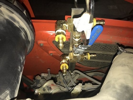

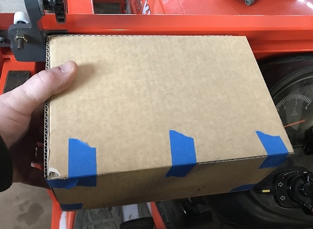

Heater Update, Part2:
A little paint and a few wires...…

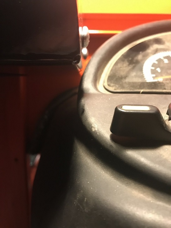

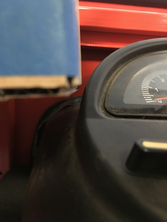

I chose to run the power down out of my switch panel instead of mounting the high/low fan switch up top. In doing it this way, I only had to fish 2 wired thru the A pillar channel instead of 3. I was short on room and chose the former path.
Clearances were as expected IF someone would have been paying attention during the mockup! Notice anything odd with the first picture in post 55? Well the dummy mocking everything up left the windshield open! When closed, there's a bracket that wants to occupy the same space as the front left corner of the heater box. Nothing a Dremel, some aluminum and JB weld didn't cure. I need to fire that SOB off this job before he makes any more mistakes!
The hoses and means of easily disconnecting them has been a challenge. Since I have no idea at the flow rate across the bypass hose, I opted to not use hydraulic quick couplers. They need to get crazy big if you look at a flow vs pressure chart! I'm planning on valving off the heater supply after the bypass loop and disconnecting the cab heater via SAE flare swivel connections. I'm not sure why, but this little voice is telling me I'm making this way tooooooooo complicated. Good thing I'm nearly done.
I've included pictures of the completed heater install, clearance to dash and mock up of my bypass valve mount.
Feel free to ask questions & hope you enjoy.
