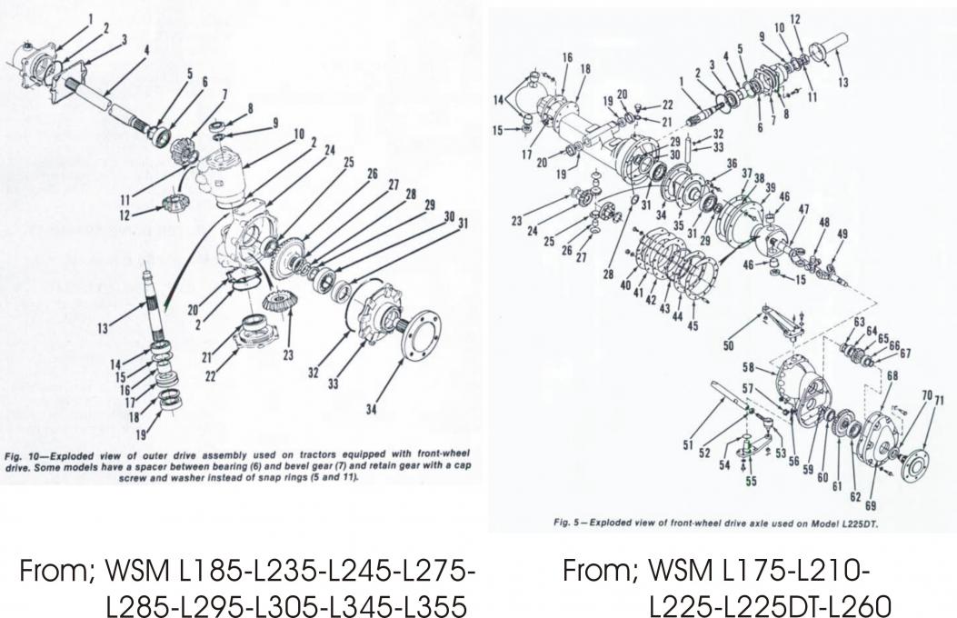

I was brush hogging and the right front wheel took off across the field on its own. The axle broke between the wheel and housing. I found a used axle online (Kubota wants $1000 for a new one). It is off a L185dt. Will this fit my ZL1500dt? Also do I need any other parts to install it?

This is the man to talk too, to answer your question. He just did a complete restore on his :D
http://www.orangetractortalks.com/forums/showthread.php?t=26492
The l1500 is actually a mixture of a couple different tractors. And I don't believe the front end is the same as the l185. But send bill a pm if he doesn't respond to your post here and he should be able to point you in the right direction :D

The drawings help a lot. I fond a axle online it should be here by the end of the week.
Are the bearings pressed on axle? I have not taken it apart yet because of were it is setting.
