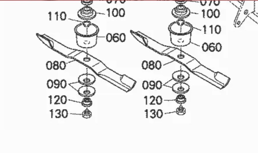

Yes, I had an extra set of washers and installed them last time the blade loosened.
Extra set of washers?
This is what should be holding the blade (outer ones shown). A bolt, a splined joint and two cup/spring washers. So not ordinary washers. Correct tightening torque is important.

The bolts and spring washers need to be torqued with a torque wrench. 85 ft lbs is what I seem to remember off hand
If you tighten with an impact gun you risk stretching and stripping the internal threads and you will be SOL
Yes, I have that same breakdown you have above and I have been assembling in the same fashion. By extra set of washers, I meant that I did a 2 for 2 swap. Examining the old ones, I noticed they didn't have the same camber (cup look) as the new ones. I'll admit that I haven't been torquing those bolts, but I will start doing it if you guys it is critical for these decks. Thanks for your reply and advice.
