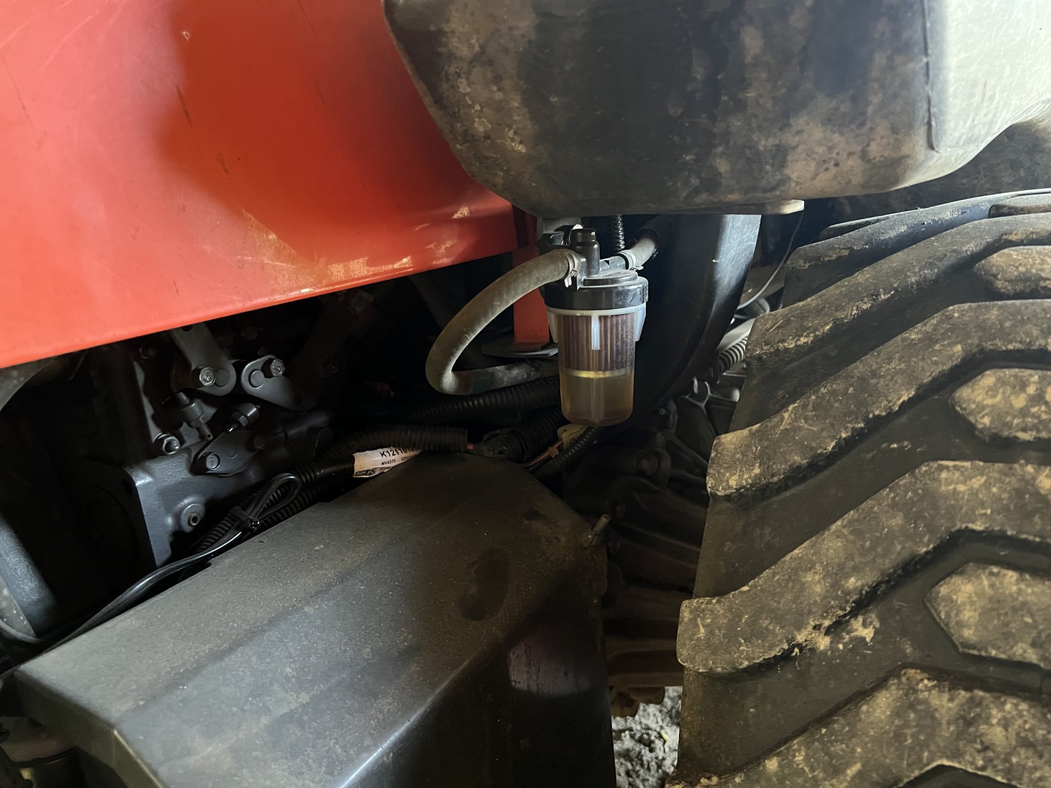

I’ll get a picture of the filter I added to my ZD this evening. Do the fuel tanks look clean? Have algae in them?
I also replaced the tank selector with a Tee. I still need to add check valves to them. If I park it overnight on an incline the fuel level will equalize and the lower tank will have more fuel in it.

Have you downloaded a service manual for your model? Or at least the owners manual?
They are useful in many ways even just the diagrams. Also Messicks has good diagrams to show parts layouts.
If you can see fuel in the tank I doubt you ran it dry. I ran mine almost out of fuel when I added this filter/water separator mainly for it to catch some water that was in the tank and it ran for a while after I couldn’t see any fuel in the tanks. It started missing and was low on power first, I immediately idled it down and drove it to my shop to fill it up.
This is what I added right after I bought it a few years ago. It’s a fuel filter from a L3800 and possibly other models, I think it was around $30 from the dealer. I did have to plug the top vent in it with epoxy.
The fuel goes from the tanks to the added filter, the first original filter, fuel pump, and second original filter, then to the injection pump. When I added it I did replace the original filters before and after the fuel pump. They are difficult to access but if I remember I removed the battery tray and the original filters and fuel pump are attached to a bracket that comes together.

I will check out that filter you added. Looks pretty neat. I just don't like the idea of opaque filters with no way to see or discard water and slime.
