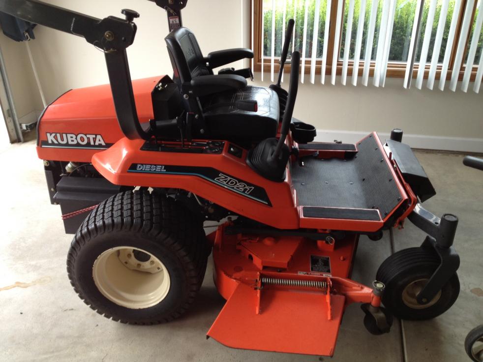

Hello guys!
I just purchased what I thought was a 2007 ZD21, but it turned out to be a 2003. The guy I bought it from bought it from a widow's estate and was told it was a 2007. Probably paid too much for it at $6k, but it's in such excellent condition, I wouldn't have believed it was more than a few years old. Only 500 hours.
Everything seems to function perfectly, though I haven't put it to good use yet. Before I do, I wanted to get a handle on the early issues of transmissions burning up because of oil starvation. So, a few questions:
1. Provided everything functions fine now, I assume there was no previous undetected damage -- or unlikely anyway?
2. Does anyone know the part numbers either individually or as a kit?
3. My local kubota dealer doesn't offer pickup service. I have a shop, hoist, tools and work on large diesels -- I assume this project wouldn't be a big project?
4. Anything else I should look out for?
Thanks for your help - it's much appreciated!
Here's a pic of the machine. Very happy with it, except for the price. Now all that's left is to find a service manual. :)

Hello guys!
