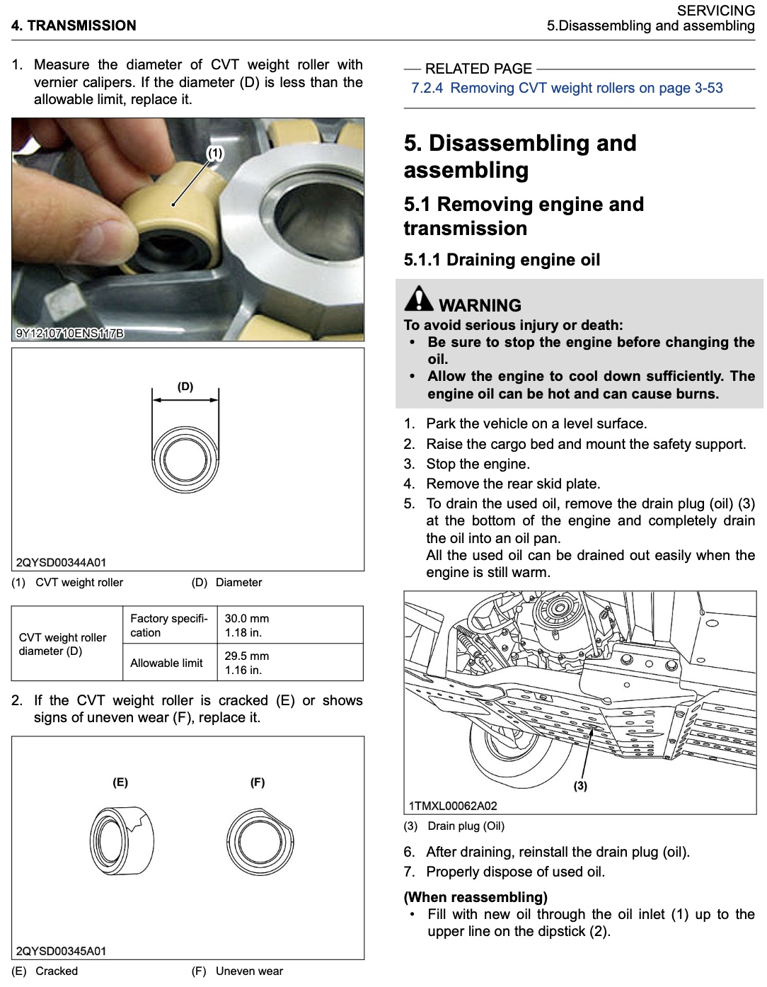

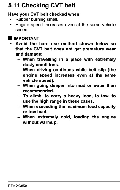

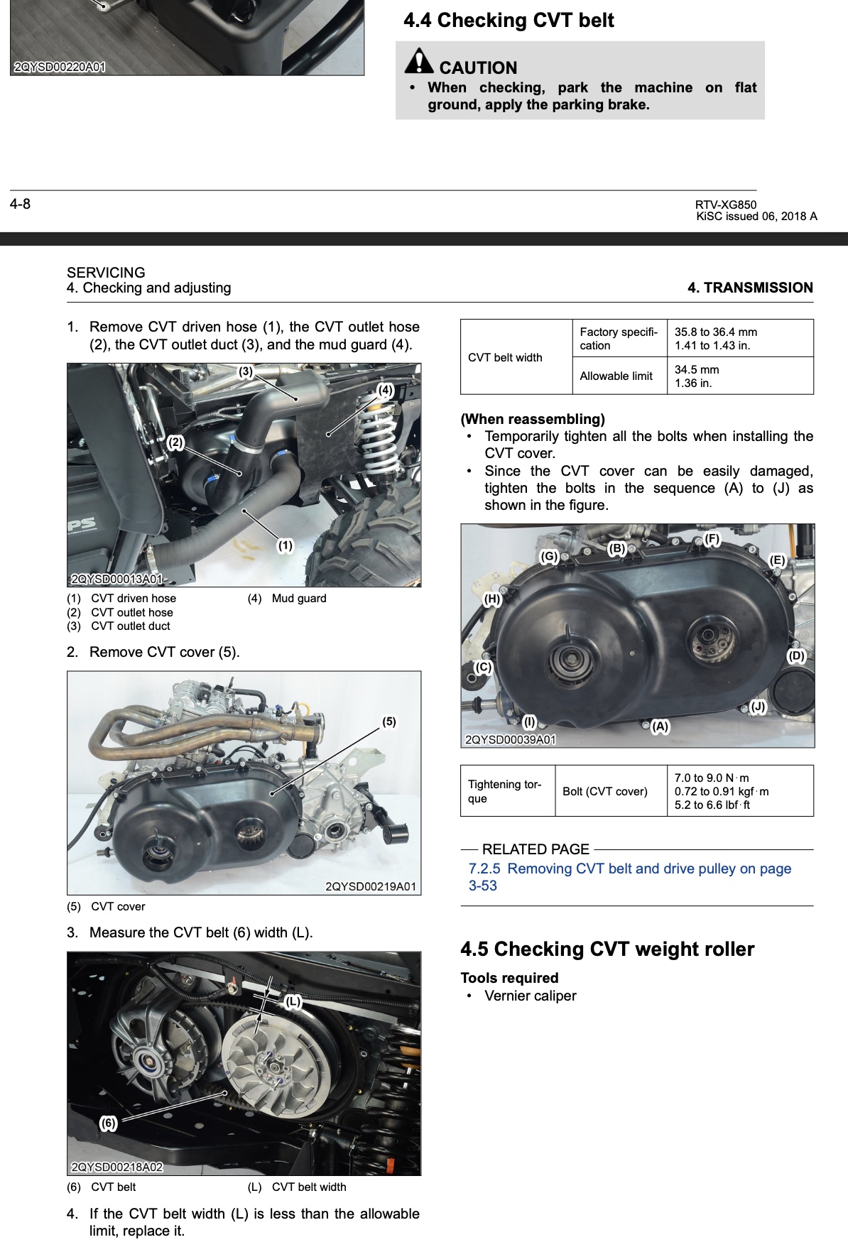

Howdy. I have had my Sidekick for 3 years now and have never checked the CVT belt. I looked in the manual and it says check it every 100 hours. Well I am over that by two.
I was looking at Youtube and couldn't find a video on how to check it or change it.
Anybody have a video of this, or a how two?
