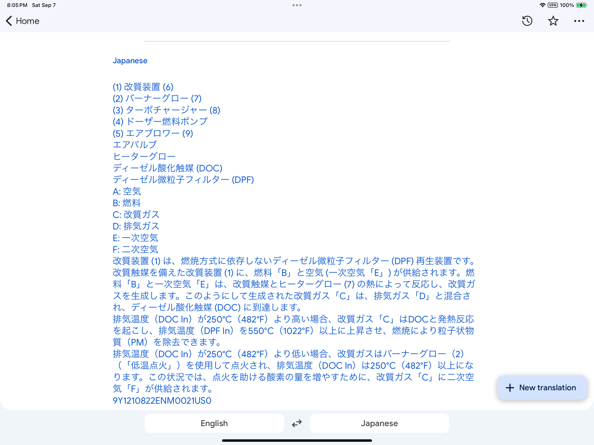

out of curiosity, I copied some text from a PDF manual for a Kubota tractor, and used Google Translate to translated from English into Japanese. I don’t have a Japanese manual or I would’ve done the reverse.
Anyway I’m going to attach a screenshot of the translation to give you an idea of what you can do.
so if you have a PDF Kubota workshop manual in Japanese, you certainly can do the reverse.
edit: the text for numbers six through nine is shown, but for some reason the numbers are missing. Not sure why that is… But the message is still there
Just a FYI.

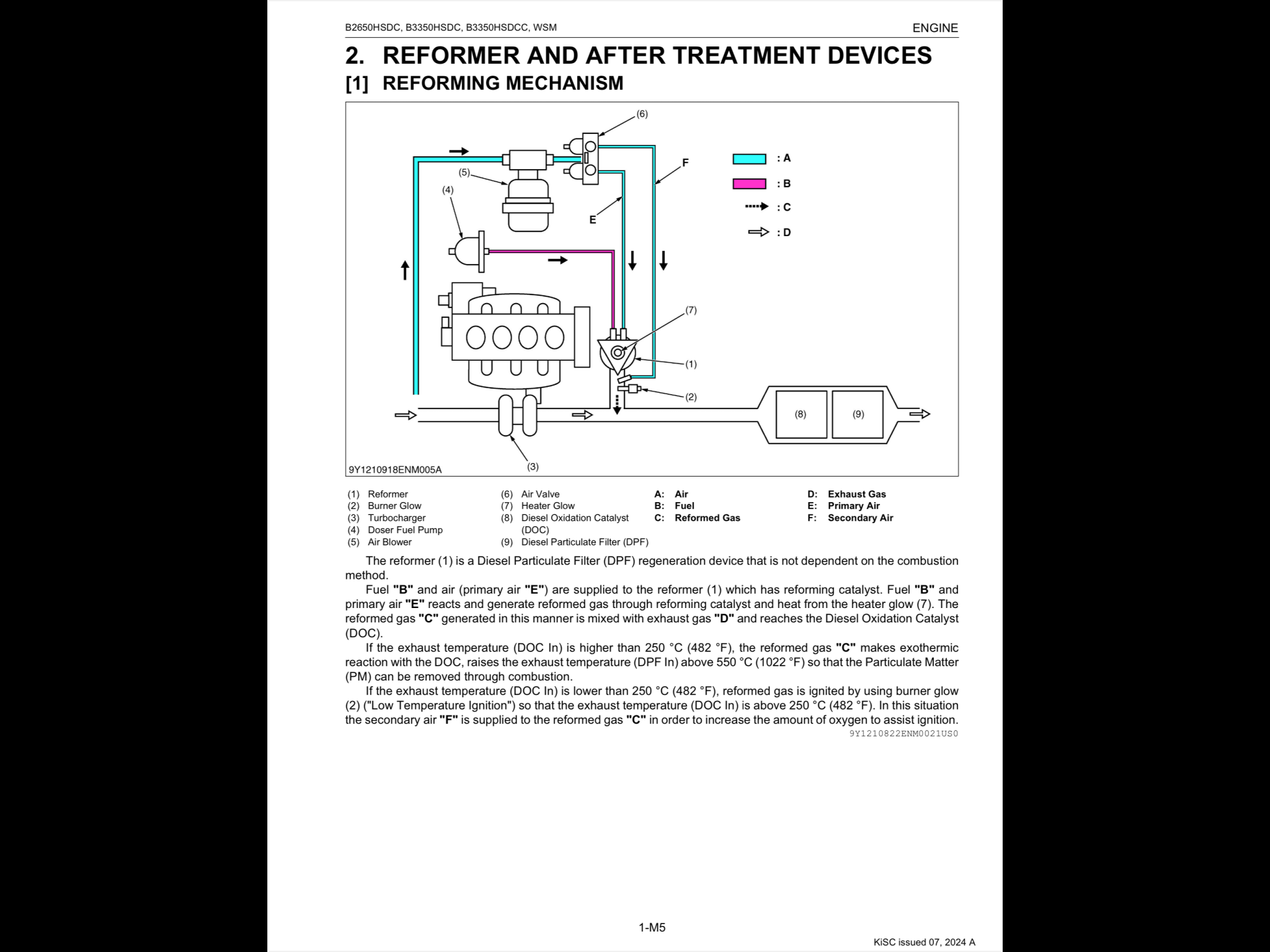

for reference, the following screenshot shows the English page. I just copied the text below the image shown in the box.
