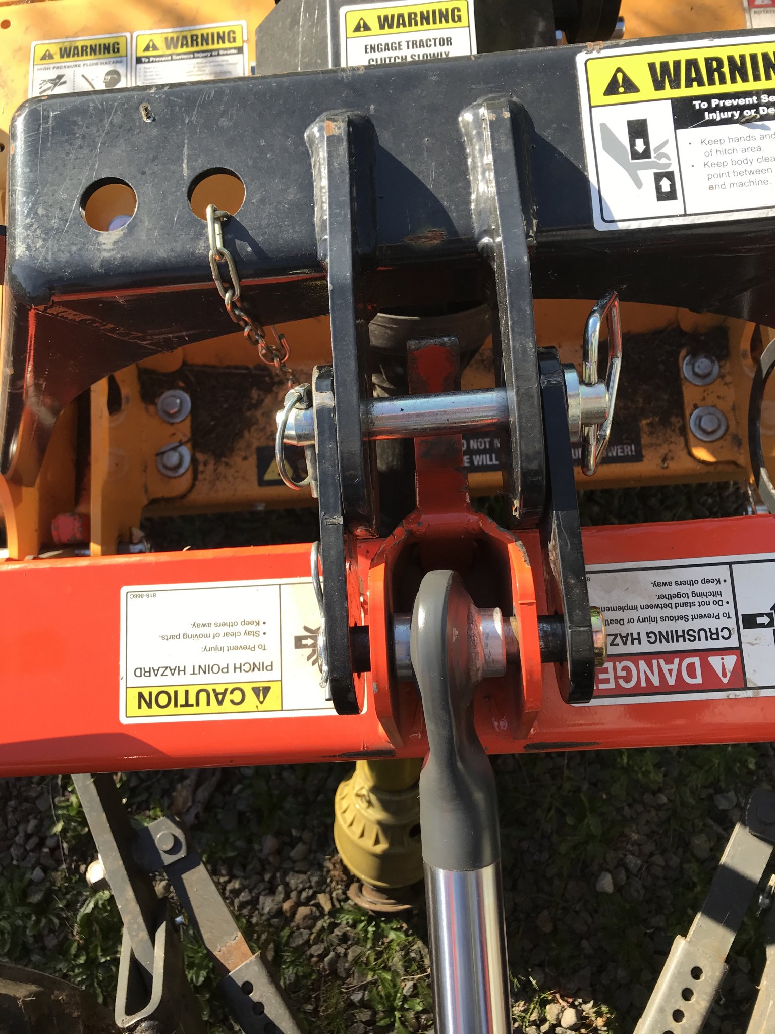

Since we’re talking WoodMaxx flails, we may as well talk about how to mate them up to a Quick Hitch. They are not QH-ready, but it’s a super simple mod to make it so... Please see the photos and note that the slotted hole still functions as it should, allowing the flail to follow the ground contours.
This is a simple pair of 3/8” x 2” flat bar. 3/4” holes are about 4 1/2” apart. I leave the bars on the QH all the time, and they do not interfere with any of my other devices.
