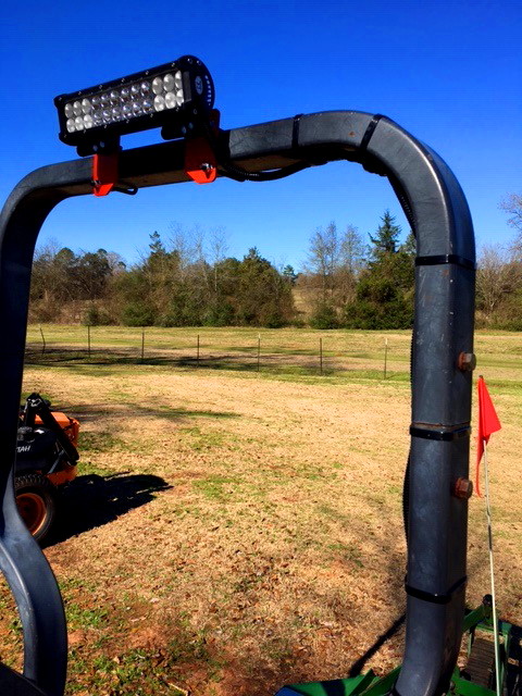

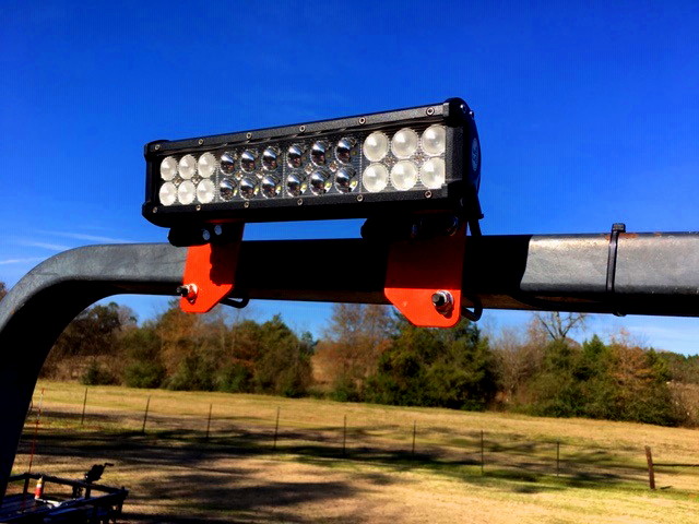

I'm not real big on Zip Ties either (aesthetically speaking), but did use them on my light bar installation.
I need to repaint my ROPS and I don't think they will be as noticeable after that. But might revisit this thread to see what the OP comes up with.

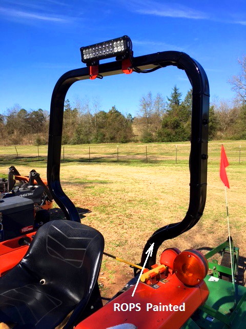

Edit to add pic: After painting the ROPS....the Zip Ties I used are much less noticeable. I will probably just leave them as is.

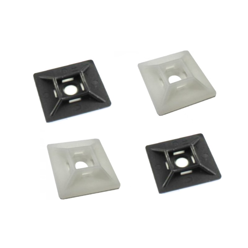

Thanks y'all. Those zip tie mounting bases look perfect! Definitely found them in black but dang, the minimum order and shipping is a little bit of a b$@!#. Need to develop a local network of folks who use supplies like this on a smaller scale to share the load. ;)
I have been using them for years, and love them.. Understand there are two different sizes. The normal size is about 1 inch sq. and the other is about 1/2 inch sq. Get the 1" sq ones. I have them on my light bar to my Side by side, and several of my friends. i have them in back of my Oled television to manage cables. Get them in bulk if you can, in black or white. You will go through them faster than you think.

Just so everyone know they do make the wire tie mounts in black and white, and two different sizes.
1x1 inch sq, and 1/2 x 1/2 inch sq. When I wire I use them with the ribbed plastic casing just to give
the wire a little more protection.
