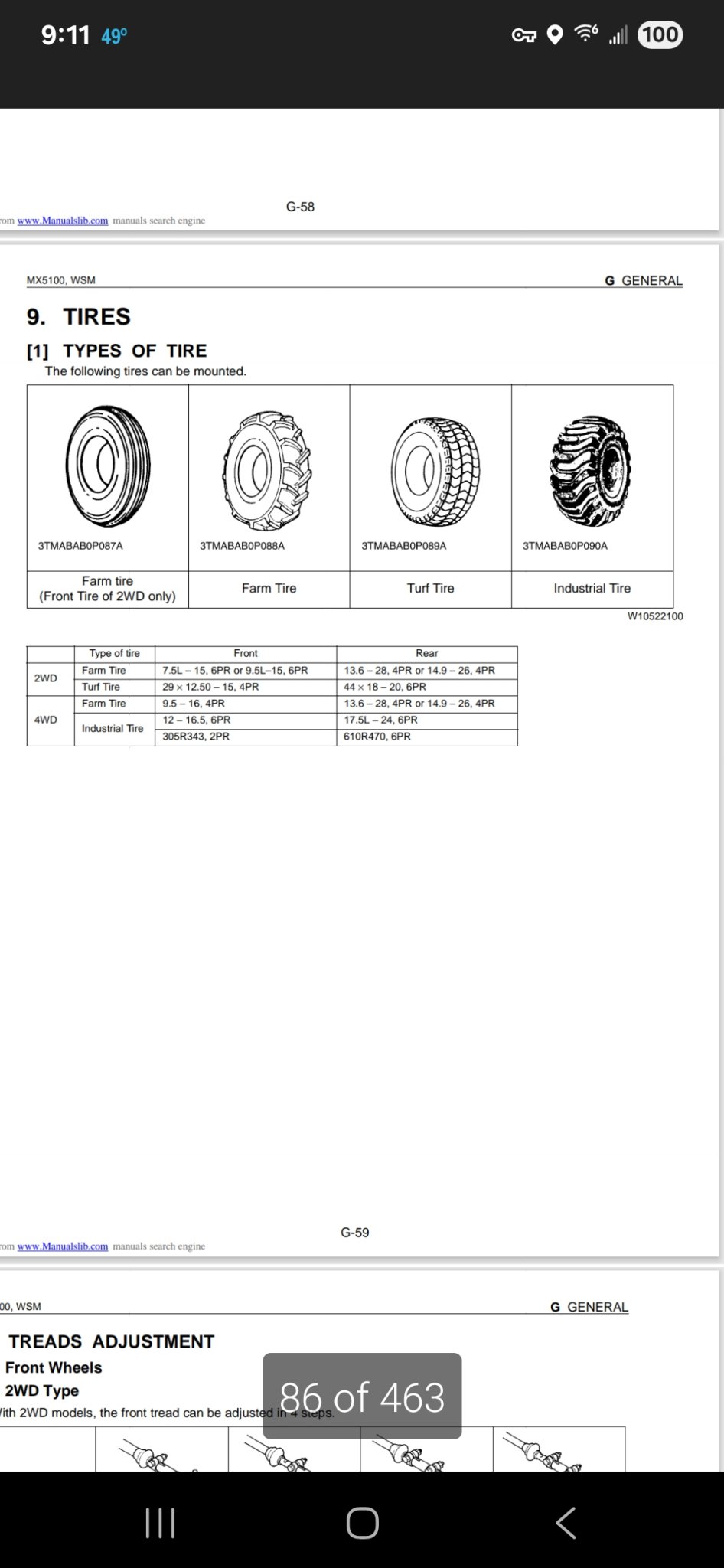

Will these R4 Wheels and tires fit my MX5100?
Casper1
MX5100
May 17, 2025
17
12
Kubota!1
Bolt circle is 6" front and 8" rear. I haven't gone out to reconfirm mine, but it seems close to what I remember when measured years ago going through a similar exercise when thinking about R14's. I'm more worried about the ratio since these are not the same height as my R1 Ags/chevron.
Thanks in advance.
Front 12-16.5 R4 Titan HD 2000
Back 17.5L-24 R4 Titan
jyoutz
Jan 14, 2019
3,400
2,447
Edgewood, New Mexico
Thanks in advance.
Your owners manual should have specified R4 tires for your machine.
