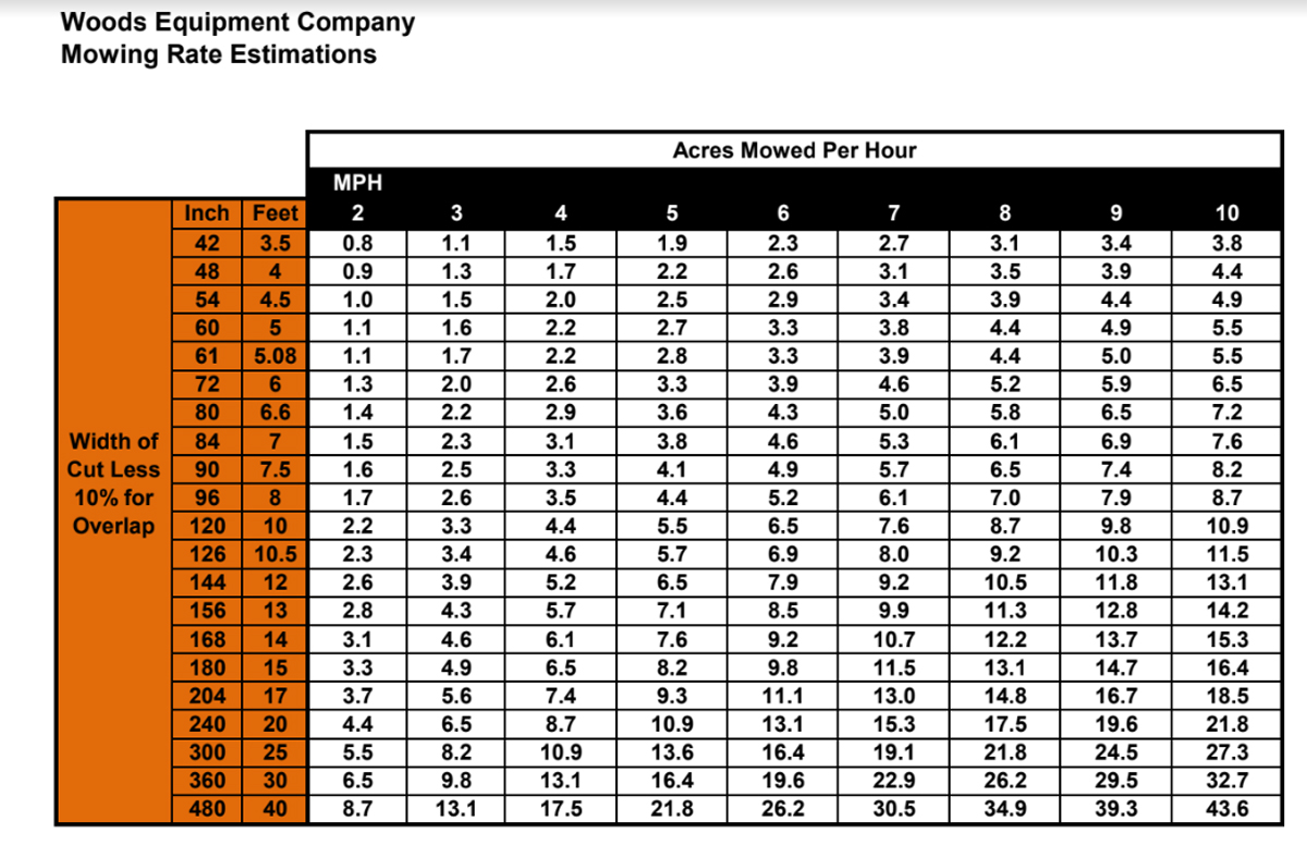

Cutting 14 acres with a 6ft or 7ft rotary cutter is going to take around 11 hours, and maybe more, and if the field isn't nice and smooth it'll make for a long day, particularly with a short wheel base and small tires.

I have a spreadsheet that I use to figure out what I need to charge when doing tractor work for others over the summer months, but this chart from Woods is interesting. I don't think it accounts for changing direction at the end of a pass though, which can really add up.
