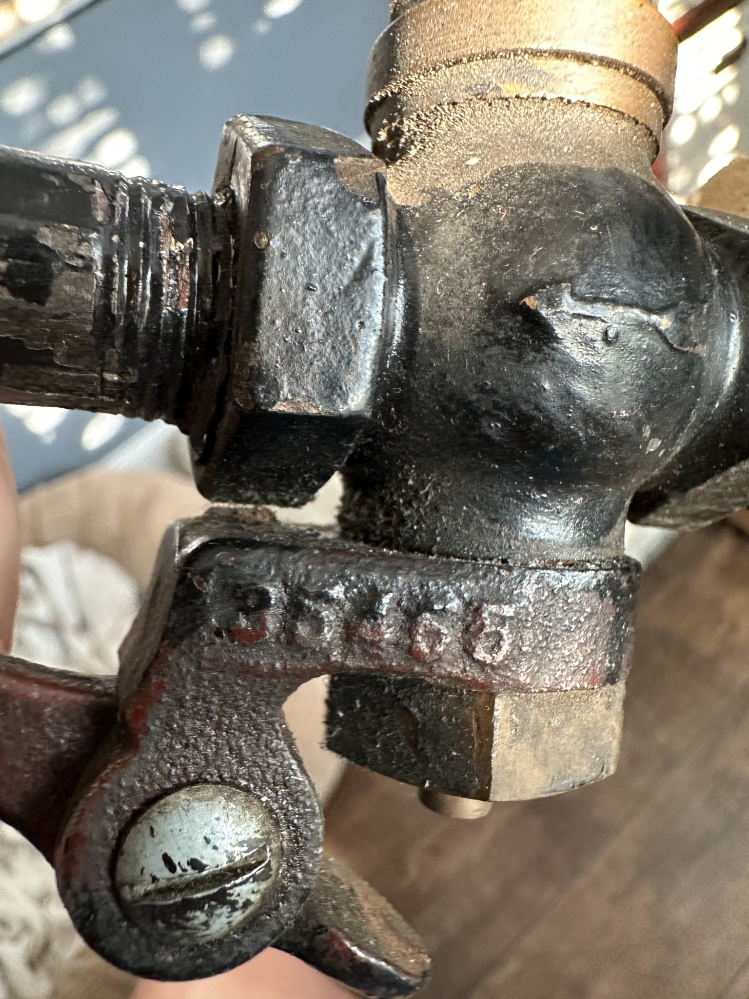

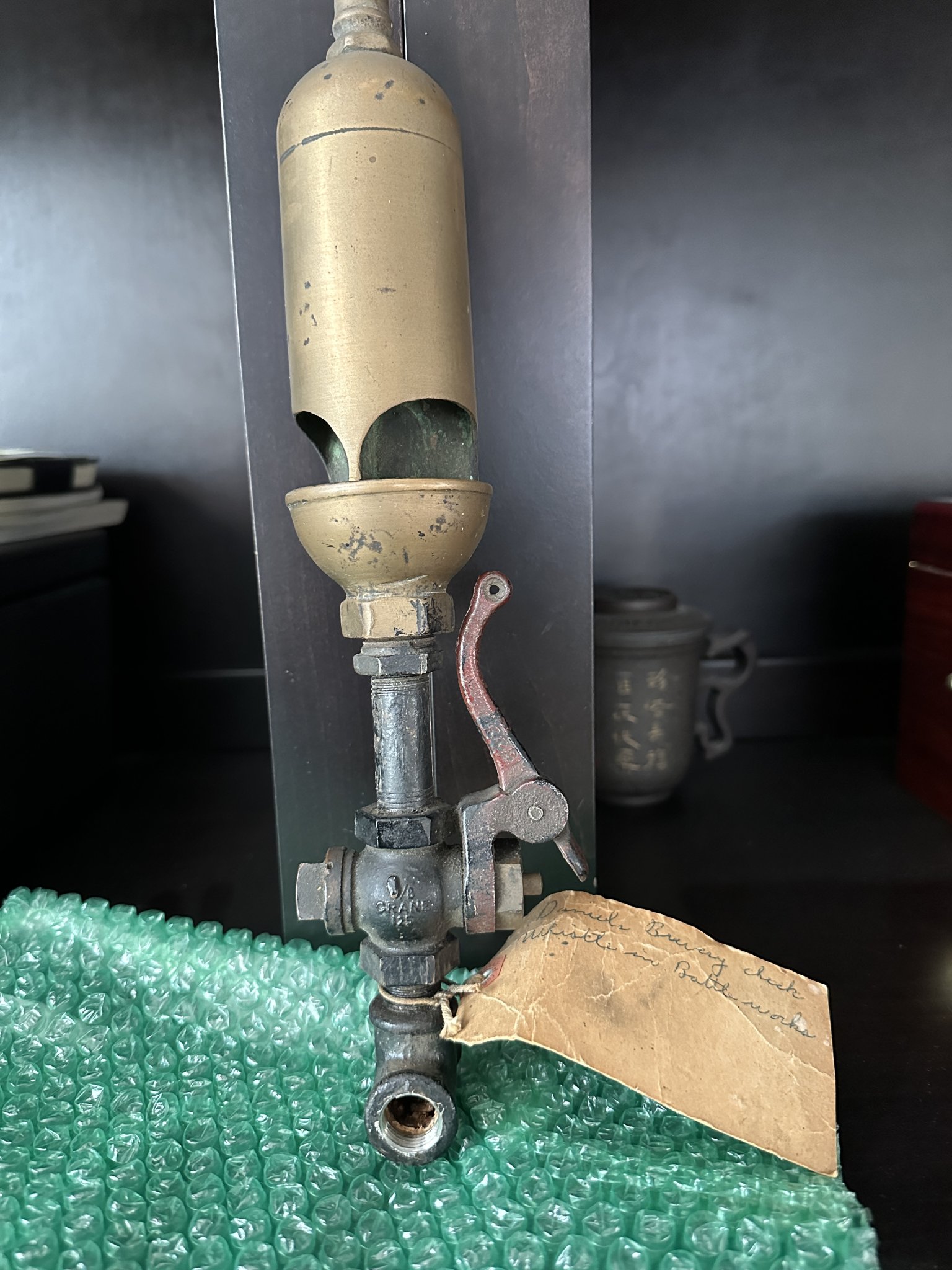

Stumbled across this gem and brought it home. What I know is it is from the Daniel’s’ Brewery in Manistee MI and was used for time notifications from around 1884 up to the early 1930’s. Not sure the manufacturer of the whistle, more research needed there. I have questions on the fittings from the whistle to the valve. From what I can tell without disassembling it is the whistle has a 3/4 NPT and reduces to a 5/8 OD NPT. The valve moves freely and has good spring rebound. I have not inspected the seat yet. The valve is marked Crane 125 and what looks to be a number /8. Thinking that is 5/8. On the lever it is stamped 15221. The mount for the lever is stamped 35465. On these my thought is both of these refer to the casting part and can be individually replaced if they got broken. Not coming up with much on specs on the Crane valve.
I’d like to get some air through it and see how she sounds so I’ll remove that bottom T and hit the hardware store. Everything I have for pipe is 3/4 or 1/2. I need to rig a way to get an air line attached and stand made to mount it. Any whistle enthusiasts amine the Orange?

Got the T off easily. Low amount of rust buildup left in it. I can see the valve actuate and that is all brass so no rust. Hopefully it is making music by Saturday

I believe it's a 3/8" valve, that's the only pipe size that's an eight. The Brewery was probably using steam.

Finally got it outside and hooked up some air. My compressor is woefully undersized to blow this. I need an unrestricted 3/8 line and a ball valve to and then it will sing. Next stop….. compressor shopping

I have a 1/2" line (with ball valve) from my 20cfm at 175psi compressor.
You will need good quality ear muffs!

Most likely steam in the late 1800’s. That old have been in place for brewing and heating. The sound of the whistle is different on compressed air vs saturated steam. Personally I think it loses some of its soul on compressed air.
