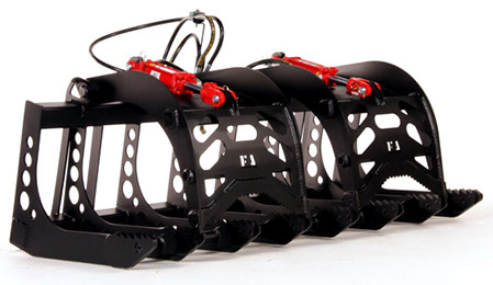

I have what people refer to as an Origoinal AE Wicked Root Grapple going on close to 10 years now. The one with the really long tines like the pic I got from the internet. Right tool for my jobs for sure. No regrets.
It gets a lot of use and holding up very very well. No complaints. Can't speak on other makes as i do not have any.

For reference , this is the type of root rake I’m in the market for. EA’s are awesome but I need something that is available with a much shorter lead time!
