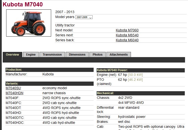

Thanks guys. Next time I'm out there I'll check the nameplate. There is definitely a guard on the shuttle lever but the clutch sure feels like a conventional. If it is hydraulic, can all shifting, gear/shuttle/range, be done clutchless?
