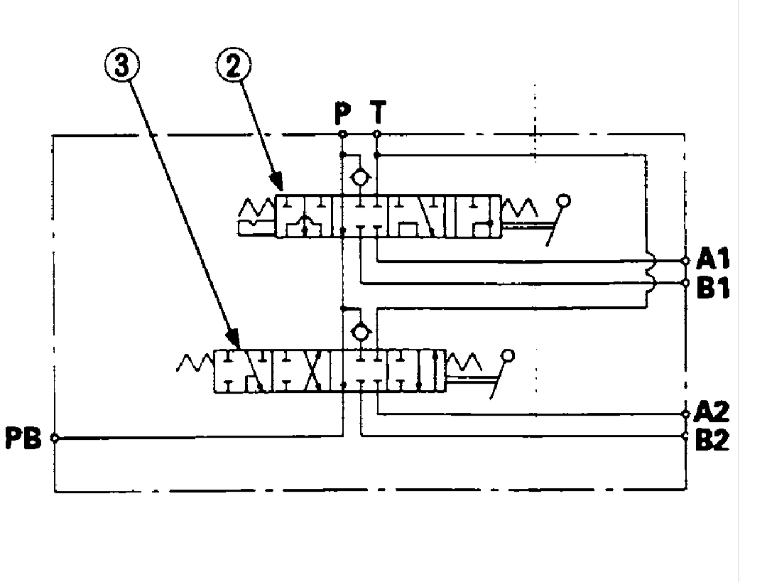

If you have a WSM for your loader, you can see if it has the fourth position on the bucket valve Dan mentioned. Here's the diagram for the TL720 loader on my L35. A2/B2 go to the curl cylinders, you can see the regen path at the 3arrow.

Probably just like must guys on here, I can fix just about anything with my hands. My know-how comes from either experience or trial and error(YouTube is helpful too) I'll be perfectly honest, looking at diagrams, whether hydraulic or electric, you might as well be talking to me in Japanese. I just don't follow them.. Lol. Thanks for your input.
