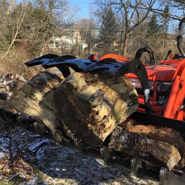

I have the single lid and I have used it on brush, logs and rocks and it still amazes me how much work you can do with the grapple. I used it all day yesterday around a huge burn pile and it is a beast. I purchased the 60 inch wicked root grapple and opted for the single lid due to price concerns and weight. Whichever you choose you will be happy as that will be the one you will learn to use. I've found that the hardest things to pick up are the big stumps from pushed over trees. I'm getting pretty good at moving those also.
