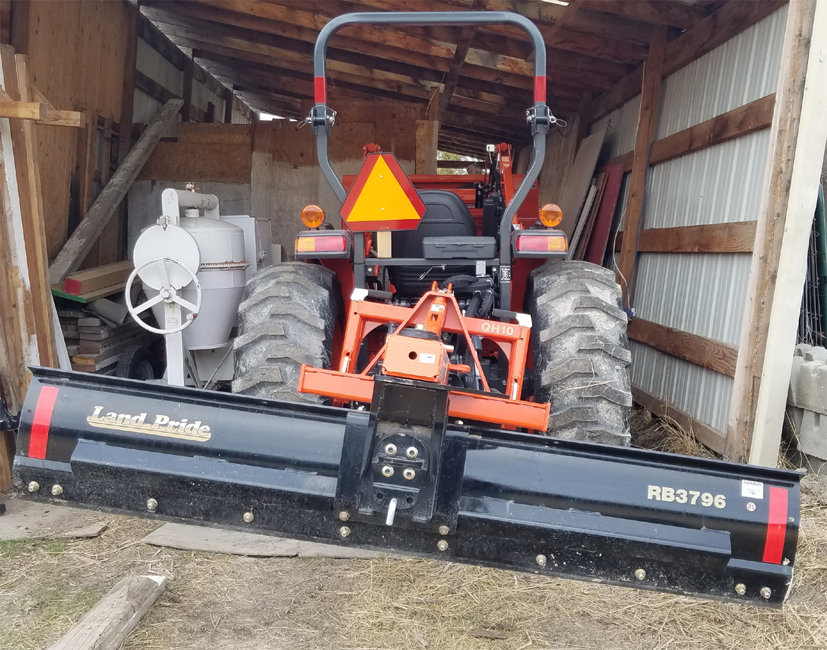

I bought a Land Pride RB3796 when I bought the MX6000 open station a few years ago. Rather foolishly I sold it with the MX for what I had in it i.e. $1,750. They're now up around $2,500 so it was a mistake to sell it but I didn't think I'd use it much once I bought a box blade and land leveler from EA. I now realize that it could be useful in the winter months to push snow over the edge of the lower driveway because I can't always get close enough to the edge with the 96" snow blade to safely push the build up down the hill. It would be useful for some other projects too, but would mostly see winter use on the back of the M6060.
If I ever buy another rear blade it would most likely be the RBT3596 that @MtnViewRanch mentioned. It's only $4,775 at Heartland Kubota in Sheridan, WY. 😂 Option 2 would be to buy another RB3796 and add hydraulic cylinders and hoses which could be accomplished for a lot less than the $2,225 difference between it and the RBT3596.

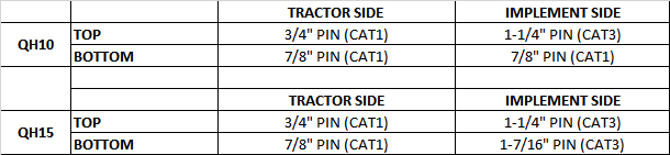

I have a QH10 and QH15. Here are the specs of each. I've attached both to a variety of implements where some require bushings and some don't.

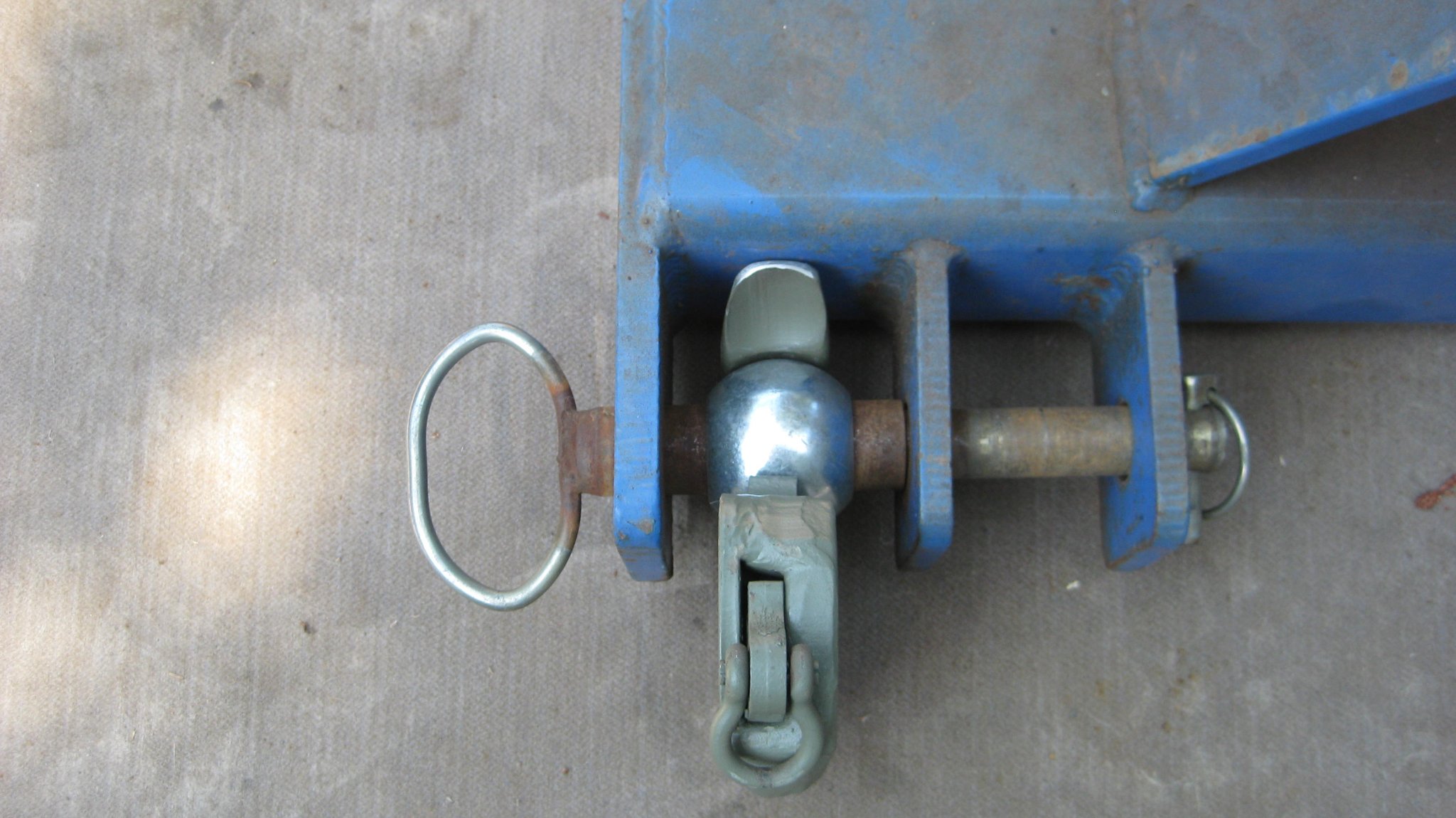

People talk about using the same hitch for both cat 1 and cat 2 implements. My belief is that they are actually talking about the pin-size bushings required for the actual quick hitches.
Otherwise, how would it even be possible to connect to both cat 1 and cat 2 implements that are not set up with the cat 1-2 double clevis connection points as pictured?
I mean, cat 1 is 28" wide and cat 2 is 34" wide.
That is 6" difference, how would anyone have fixed connection points to fit both sizes?
They can't.
