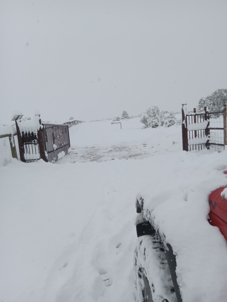

I had a friend of mine who does custom fabrication build my entire gate and opener system. The gate is 16’ wide, heavy, and swings freely without sagging. He used over 10 80 pound bags of concrete to anchor the posts and swing panels. The post pipes are 5” diameter and the gate frame is the typical 2 3/8” pipe. It’s been working perfectly without sagging for over 12 years. The weld/on hinges need a shot of grease annually. The AGM battery operates the gate and it is kept charged by the solar panel..

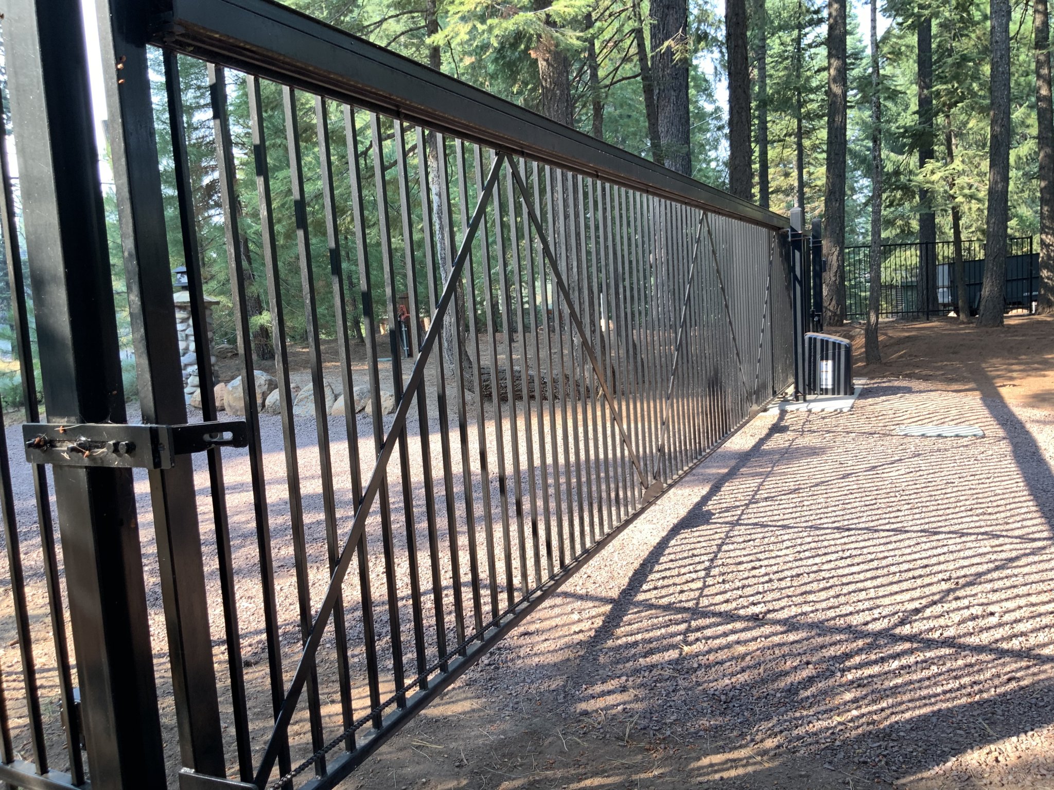

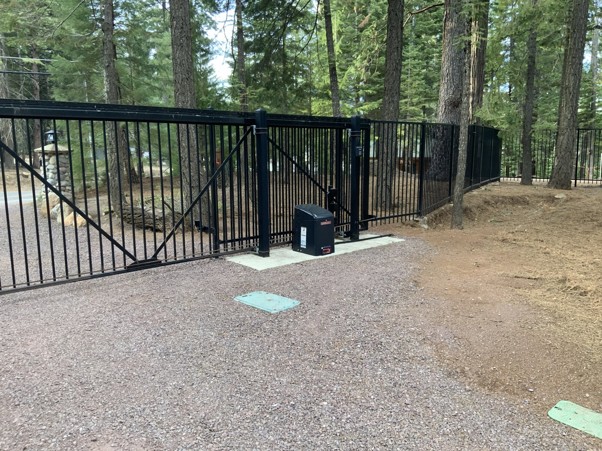

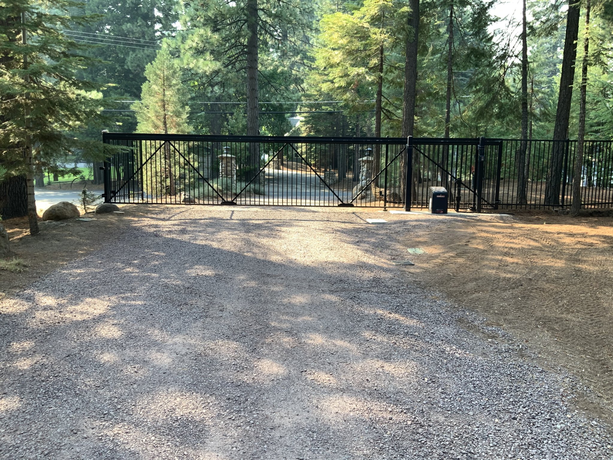

In snow country consider using a sliding gate…less digging…ask me how I know. I built my own. 26’ clear span, no rollers to clog up. Weighs about 800-1000lbs.
As others mentioned…figure out the opener system and gadgets you want (remote control panel, loops, power etc.
Get a commercial grade opener or a beefy one that easily exceeds you needs. Heat and cold contorts the gates if they are big enough and will stress things.

Very good point. And as you can see from my photo, there was considerable digging to open my gate. If we are expecting deep snow, I’ll offer just lock the gate open.

Figure out how you wanna plow or move snow around the installation site. In one of the pics you can see a trench I dug so snow wouldn’t block the opening of the gate unless is was a couple feet deep. That is why I didn’t want a track or wheel either. Snow or ice would clog it up or build up and jam the gate. I usually just clean up, by hand shoveling, when things pile up…
