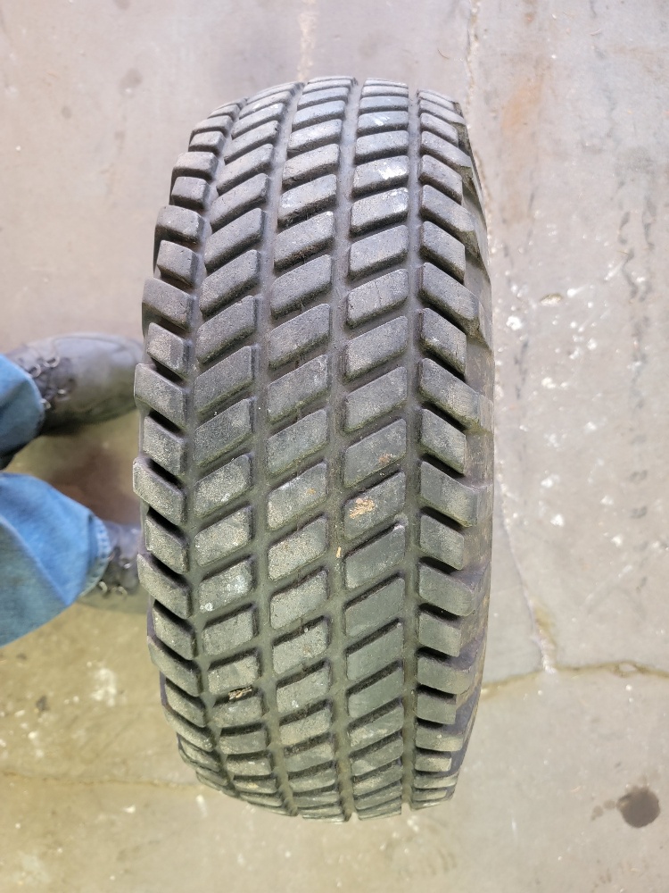

Here's the Field tire I'd like to find in a 4 ply

Hey sorry for spacing out or getting distracted, I believe what I was trying to say was looking for Turf/field tire with a similar tread layout of my example and lug pattern and being interchangeable. I have the second set of rear wheels (tire in pic. with that good looking pattern design is the one I mentioned of being rotten on the sidewalls, but like to fine without having to go extreme in cost) and just one set of fronts which look like a diamond block that kind of looks like something I've see a 2WD lawn tactor and they usually have a low weight rating

Bart and others, well I finally made a decision on rear turf tires and went with these "BKT LG 306 Turf Lawn & Garden Tire - 27X8.50-15 LRB" after seeing a real photo and reviews
