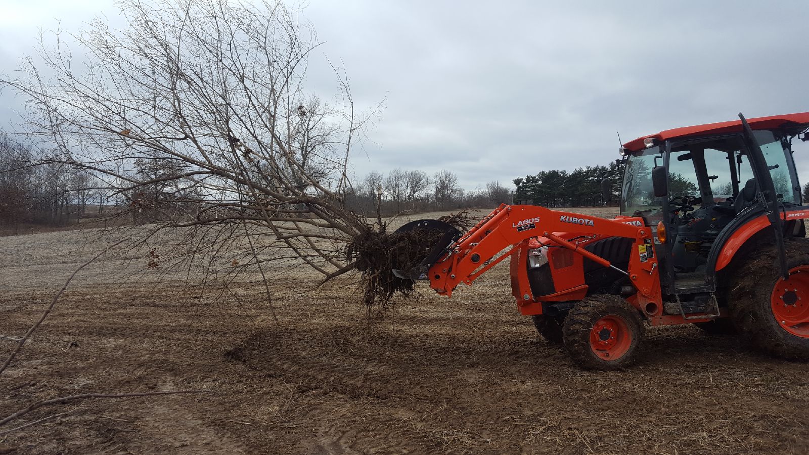

Newbie looking for advice regarding what type of grapple to get . I looked at the land pride and noticed that style does not have much of a gap when closed between the lid and the bottom . I've also looked at this MTL that has a larger opening when the lid is down .
So I'm wondering if this is the major difference between these two styles, one maybe better for pinching things like brush in the lake and the other with the opening better for grabbing things that are larger. I do not have brush on my 1.6 acres, and will be using the grapple to help me lift things with my aging back . I do heat with firewood and split my own wood so this would be helpful moving large stumps and potentially logs . I'm concerned about the inability to clampdown though with the more open design . Any other considerations or advice with respect to my choice . I have looked at the EA weighed grapple that people seem to really like here . That design also clamps down more narrowly .
Very much appreciate people's advice and guidance here.

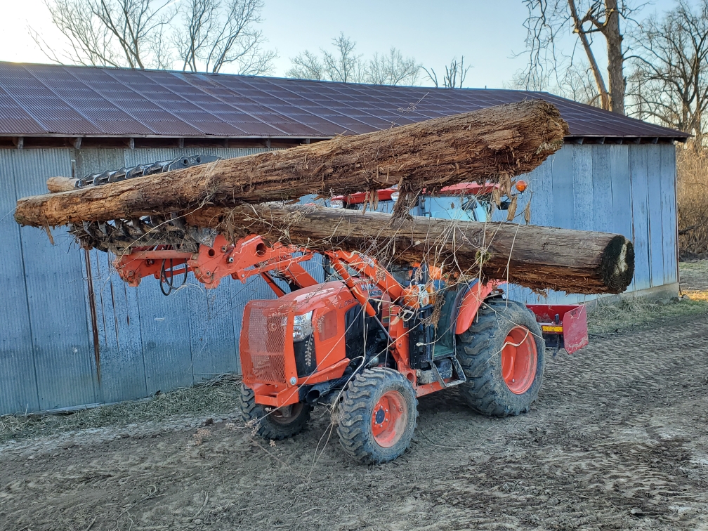

I have the EA 55" Wicked Root Grapple. Depending on what your needs are determines which grapple will work the best for you. The clamshell design has worked well for me. Realizing that any of these grapples work better than no grapple.

Thank you. I'm just very curious if the main difference is in weight and then the amount of open closure when the lid is down. Not sure which functionality would be best for me, a more narrowly closed grapple when the lid is down or one that is more open when the lid is down.
The MTL unit pictured above does have a good pinching action too for pulling out fence posts and small shrubs and stuff.
Really wondering about the advantages disadvantage of the amount of closure.

I went with the 55” EA Wicked grapple as the weight is only about 230 pounds. I also looked at the Land Pride that the dealer had which would have worked as well, but felt the EA was better built. This was just over a year ago so there were EA’s in stock. I only had to wait for shipping time to get it. It has done everything I have asked of it, but it a struggle to pick up multiple rounds of firewood with the single clamshell design. My main reasons for the grapple were brush, and lifting logs and setting them on my sawmill. Which it does both really well.
If I had to do over, with all of the things that are happening with out of stocks and extended lead times, if there was a Land Pride sitting at the dealer that I could get today, I would probably get the Land Pride. I think the EA is a better grapple, but I absolutely hate waiting for stuff. If you can wait, get the EA 55” wicked grapple and don’t look back.
