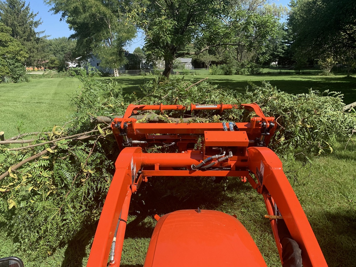

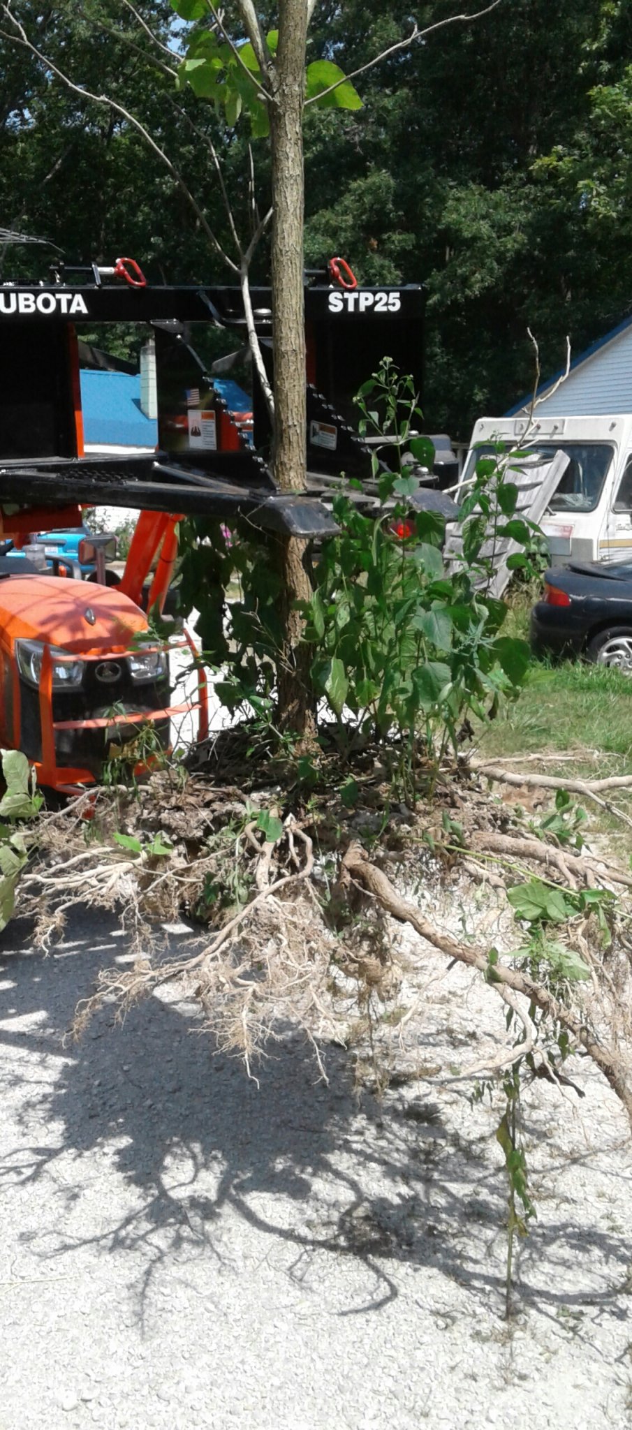

I'm on the small end of the scale with my BX so when shopping around (web and youtube), I was looking for light weight so as to not limit the carrying capacity too much. I went with an EA Wicked root rake style as a long bottom would have severely limited my dump height. Whichever style you chose, they sure beat loading brush and limbs by hand ;) Hope this helps with your decision.
