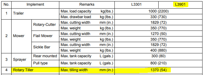

I've got a L3901 and I just picked up a nearly new / used Land Pride 58". I was going to buy a RK 60", but found this one for the same price (before tax), and the reverse rotation should be nice. I think the manual calls for a max of 54", but take that for what it's worth. Like mentioned earlier, I would consider soil condition over HP suggestions. If you're in good dirt, I wouldn't hesitate to run a 72". For me, the 58" should work just fine.

I agree that soil condition is the most important factor, secondly is your expectation of speed and depth of tilling.
Based on the manual the implement recommendations are the same for the L3301 and the L3901, what made us both opt to buy a L3901 .....lol
