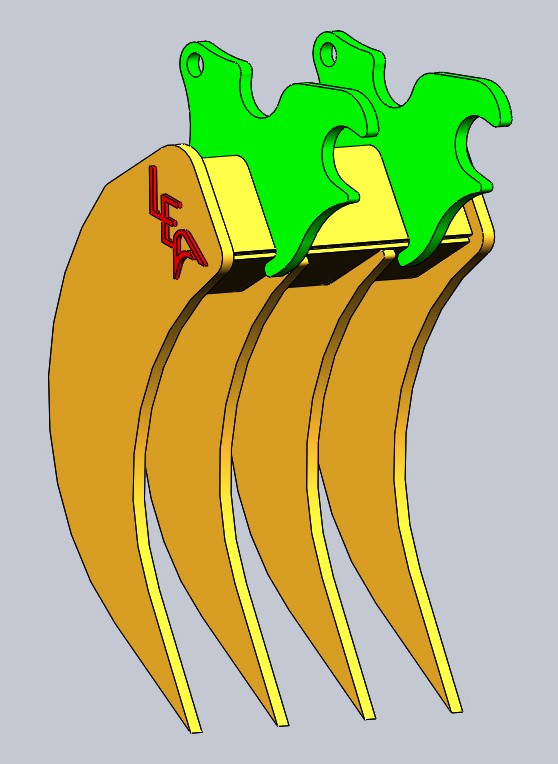

Dippybird,
You can also get a frost ripper type attachment for digging stumps & roots, it's a single heavy blade attachment, it makes much less mess than having to use a bucket which requires removal of a lot of dirt. For moving materials use large wide buckets, for trenching use a bucket width that is applicable for the trench you want.
