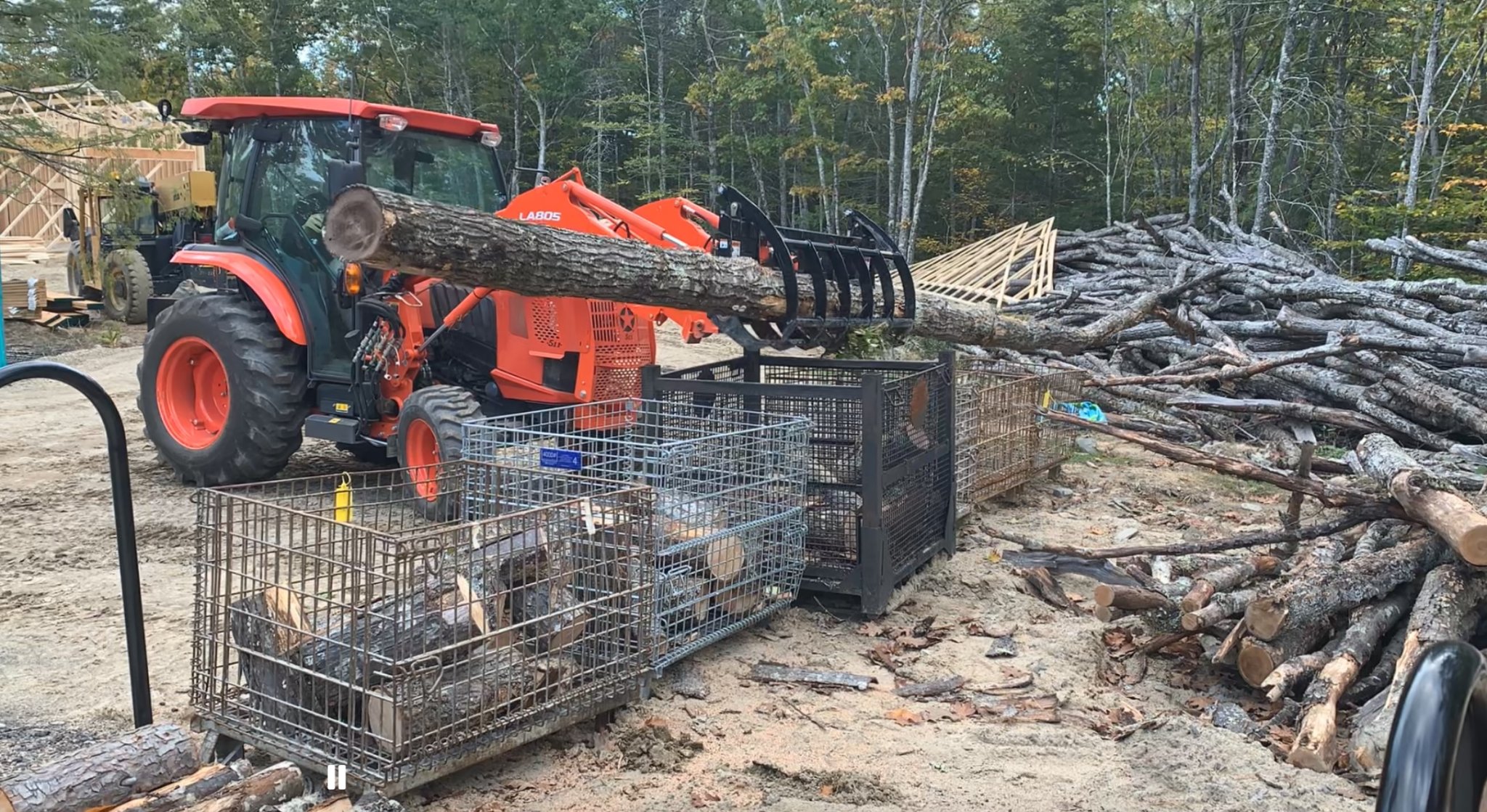

I am at 52 hours, got the oil changed no problem. Probably 3.5 months away from getting into house, however I need the tractor with grapple to move a number of logs to either get them out of the way or cut them for firewood. In the photo is a fraction of the logs.
