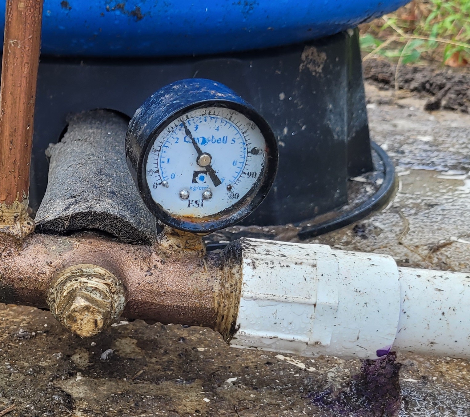

So with all that, I DO also have a leak at one of the connections.
Unfortunately it's the brass-to-pvc connection from the tee to the pipe going into the house. brass male, pvc female threaded, and the rest of the pvc is cemented. The threaded part is seeping. Drips, not much pressure, not too fast. But still not good.
Obviously I could redo the PVC but I would like to avoid that if I could. Especially since once again I won't know if the connection is good until I finished it all and repressurized.
Any suggestions on how to stop that leak without redoing it all?
Pictures will help, point out the leaking joint.
Random - - shoot a photo of that. Include the well-side of the Tank T also......

Yes I think I've covered the pressure issues. I thought I had the switch adjusted to 40 but when testing it was 38. Switch clearly indicates should be a 2psi difference. That may have been what led to the unexpected situation.
As for the leak, you can't SEE it but here's the joint.

Guys, thank you for all the helpful responses, but (a) I am aware the pressure is set wrong - I thought it was correct until yesterday, and (b) I do know how to adjust it :) - I have to adjust both of them, one controls the full range, the other controls the high pressure cut-off. This model is 3psi per full turn. Have to bump the full range up and drop the top-end so it stays at 60.
I DO appreciate the helpfulness, just that it's a resolved issue at this point. I just didn't deal with it yesterday for various reasons.
The main issue I have now is that leak and I really want to avoid having to redo the PVC (and risking the same problem yet again after I repressurize) so I'm hoping someone has an idea!

For leak, I'd cut in a union, not a couple into the pipe. Then redo the leaking parts up to the union. With the union you'll be able to tighten or remove the tank or retighten fittings as needed.
