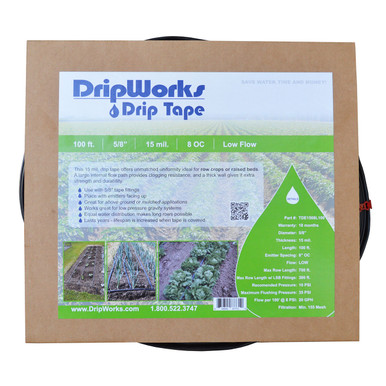

I suggest you look at drip irrigation tubes like
Or tape like this

I did some reading on the drip line. It sounds like exactly what I need. I am planning to have a barrel that I will fill with water every day or two. I can run a header off the barrel to the end of the garden area. My area is slightly downhill, so I am planning to run the lines down hill. I want a fairly slow drip. Now to figure out a cover for the barrel that lets rain in but keeps mosquitos out...
