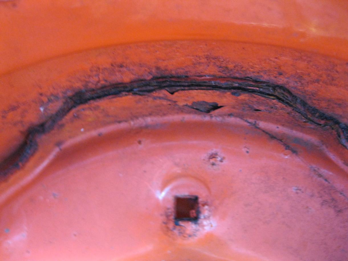

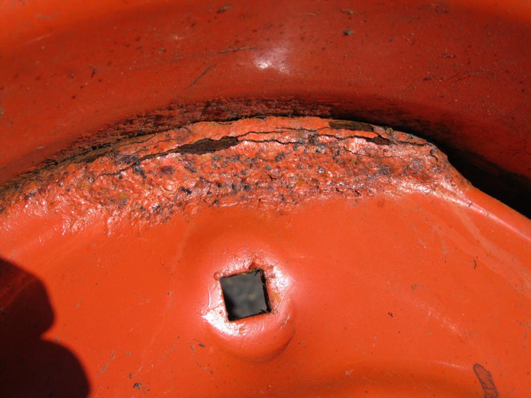

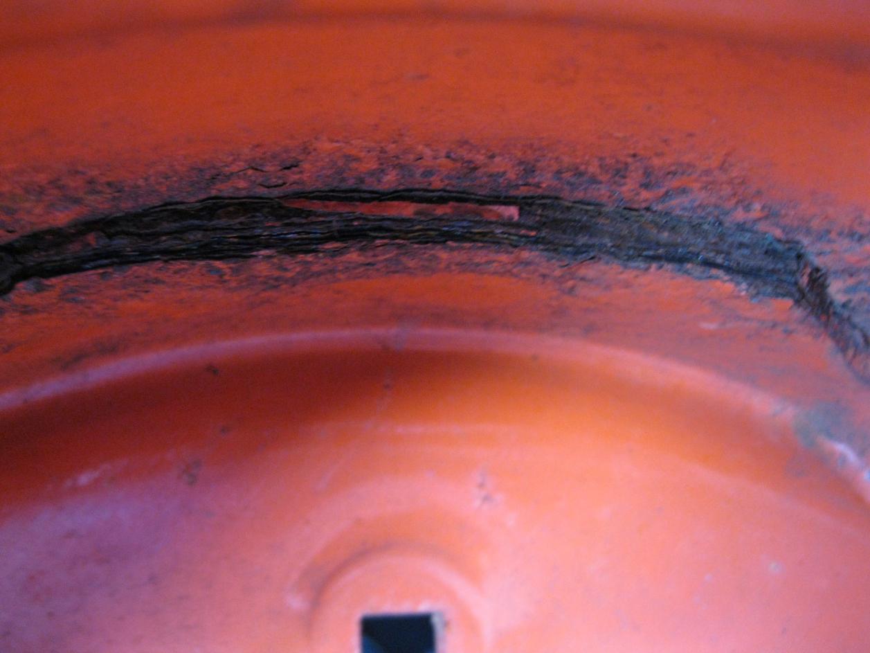

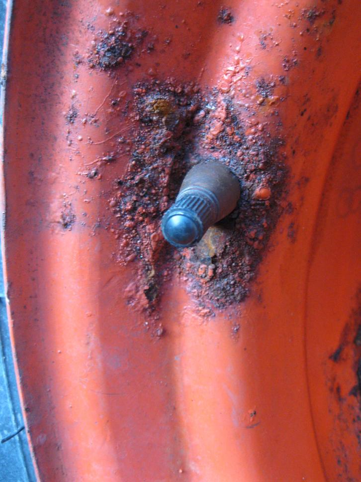

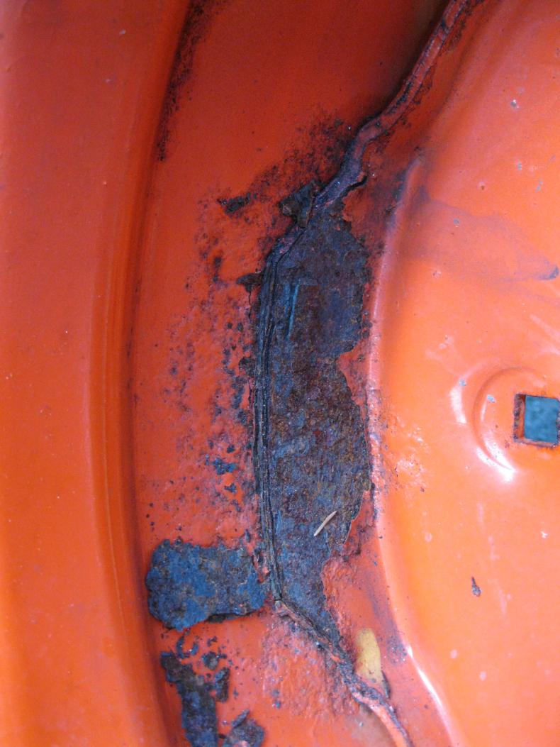

Magnesium Cloride Ballast in tube tires
My 8 to 9 year old rims are to the point of no return. They were setup with tubes and Magnesium Cloride ballast, as it was not going to be as corrosive as the calcium cloride in my original rims. It appears that the magnesium was very corrosive too.
Now I'm replacing rims again and having my existing like new tires mounted to brand new rims. My question is: Should I even add ballast this time at all ???
My setup is a B7100-D with B219 Loader & ARPS 70 Backhoe. When Backhoe was added I had to add lots of extra weight to front and middle of the tractor to keep front wheels on the ground. Especially when trying to drive up the trailer ramps.
I'm most concerned with winter use clearing snow and keeping the traction. Looking for comments on using the rig with the weight of backhoe as my weight for traction.
With the corrosion the rims have now, I'm not feeling very comfortable using the tractor. My biggest fear is tearing the rims apart from spinout in mud or under torque. That could get ugly real fast...

Except for the small amount of rust around the valve stem, all the corrosion I see on your rims is from the outside. The fluid being on the INSIDE I cannot see how the rust you are experiencing can be attributable to the magnesium chloride!

Hi Ed,
Thanks for the response. I hear what you are saying, BUT. The rims are rotting out from the inside out. The rust you are seeing is coming through from the inside at the weld points, rim edge and valve stem opening. The same thing that happened with my original rims (but they lasted 20 years). The AG tire rims also rotted out from the inside.
When I went from the AG tires to the R4 tires, front and rear 9 years ago, I replaced all 4 rims. The interesting thing is that the front rims still look like new, the rears don't. Both front and rear rims are stored in the same environment, so why should the rears look like they do, when the front look like when they were first installed?
My fear is that the level of corrosion is bad enough to actually tear the rim apart at the weld points.
I'm open to hearing other ideas. I’m just not buying into the rust being surface rust from the outside. It looks more like serious corrosion and delamination of the metal. Sorry if the photos don't show how severe the corrosion actually is.
Thanks, Dan
