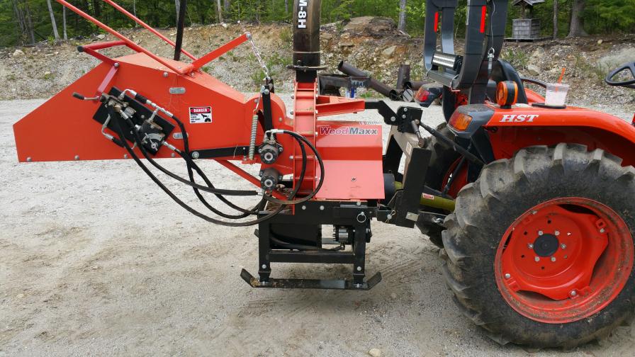

I looked at the Wallenstein chippers also. I have the same tractor as you. Same HP. But dollar for dollar and me being lazy. I bought the WoodMaxx with the power feed. Self contained hydrolics . It just sucks the limbs/brush right in. You can adjust the feed speed. And for me it chipped a lot faster then I could ever feed it. And yes its made >>>over there. I asked when I called to order it. Their largest model is made in USA I was told. And looking at snowblowers. WoodMaxx has them too. And I'm very pleased with my chipper and will most likely buy one of there snowblowers when I buy. Watch the chippers on Utube. Sorry I cant post their website as I'm not good with computers.
If you do buy one and plan on unloading it with your pallet forks. My L3800 would just barely lift it off the tractor trailer. Its not sheet metal.
