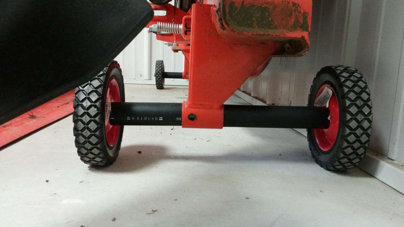

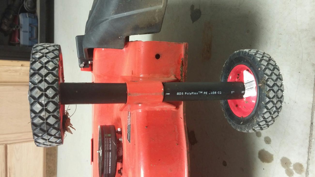

Interesting indeed;) Now how long are the axles the wheels size

Axles are 12" and wheels are 6". Drilled and taped the ends for 1/2" bolts and too a depth the bolt bottomed out just before it tightened down on the wheel. Used 1" PVC over the axle as a spacer so it stays centered.
