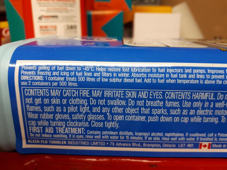

I have never used Diesel Anti-Gel additives. I have always gotten by using K-1 Kerosene mixed with my Diesel. Problem here, is that K-1 cost me $32 for 2 gallons at Canadian Tire, thus making it cost prohibitive. I have purchased some Kleen-Flo Diesel Anti-Gel additive. I have used many Kleen-Flow products throughout the years and find them to be very high quality. (Only sold in Canada I think). I have attached photo's of the product, and the instructions.
(Yes, I read instructions)..Supposedly, this one L bottle treats 500L of Diesel. For my 3901's 11 gallon tank, my calculations say approximately 2ml/cc of product to a full tank. Please correct me if I am wrong on this. 2cc's doesnt sound like much, and went to the Pharmacy to grab a couple syringes to measure that quantity.
One of the complaints I hear from the dealer is that people tend to overdose their diesel to the point of it not even smelling like diesel anymore, and the equipment starts to run poorly. I have 9 driveways contracted right now, so I really can't afford to have any issues. It has been, and appears that the trend will continue, very very cold. Haven't hit -20f yet, but real close.
Can someone tell me if my math is correct. I am originally from the States and this whole Metric system is gibberish to me. Any advise would be appreciated.

beaterboss - - I think your math is off.
If I convert your 11 gallon tank to liters, it's about 42 liters. (11/.264 =41.7)
So, I think you need a lot more than 2ml of product.....
If 500l/1000ml...500l/42l=11.9..1000/11.9= 84ml...?.?.? So, nearly a 10th of the liter of product.
I think...gosh, this stuff use to come easy for me... :eek::eek:
Somebody better double-check my double-checking....:eek::rolleyes:

You got it right, 0.084 liters (84 cc) is correct.
1 x
500 42 (liters in 11 gallons)
Simplifying to:
500x = 1 X 42
42
X= ----- = 0.084
500
It's only been about 50 years since my last algebra class, but I use it all the time to solve problems like this.

Thank you thank you thank you. It seemed a little light with what I came up with. The wheels fell off when I tried to convert Metric to standard system (ml, l, cc to qts, pints and oz). So 82 ml/cc it will be. That makes much more sense. Even at $24 a bottle, it is still infinitely cheaper than using the K-1 at the prices over here. Thanks guys, I never took any advanced math in school...LOL!! I was too busy under the hood of a car. (and chasing girls too, that is WAY more time consuming than math). I should have asked my Daughter about this, she is a whiz at this Algebra stuff.
