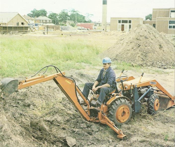

well i cant find any info either except whats on my sales leaflet.
the leaflet which the above pics is taken from is for a K629B backhoe with all the specs etc.
It clearly says at the bottom of the page " stabilized by K500B front loader"
so it must be a kubota part, but where the details are i just dont know.
i'll put up the back page of the leaflet later on.
