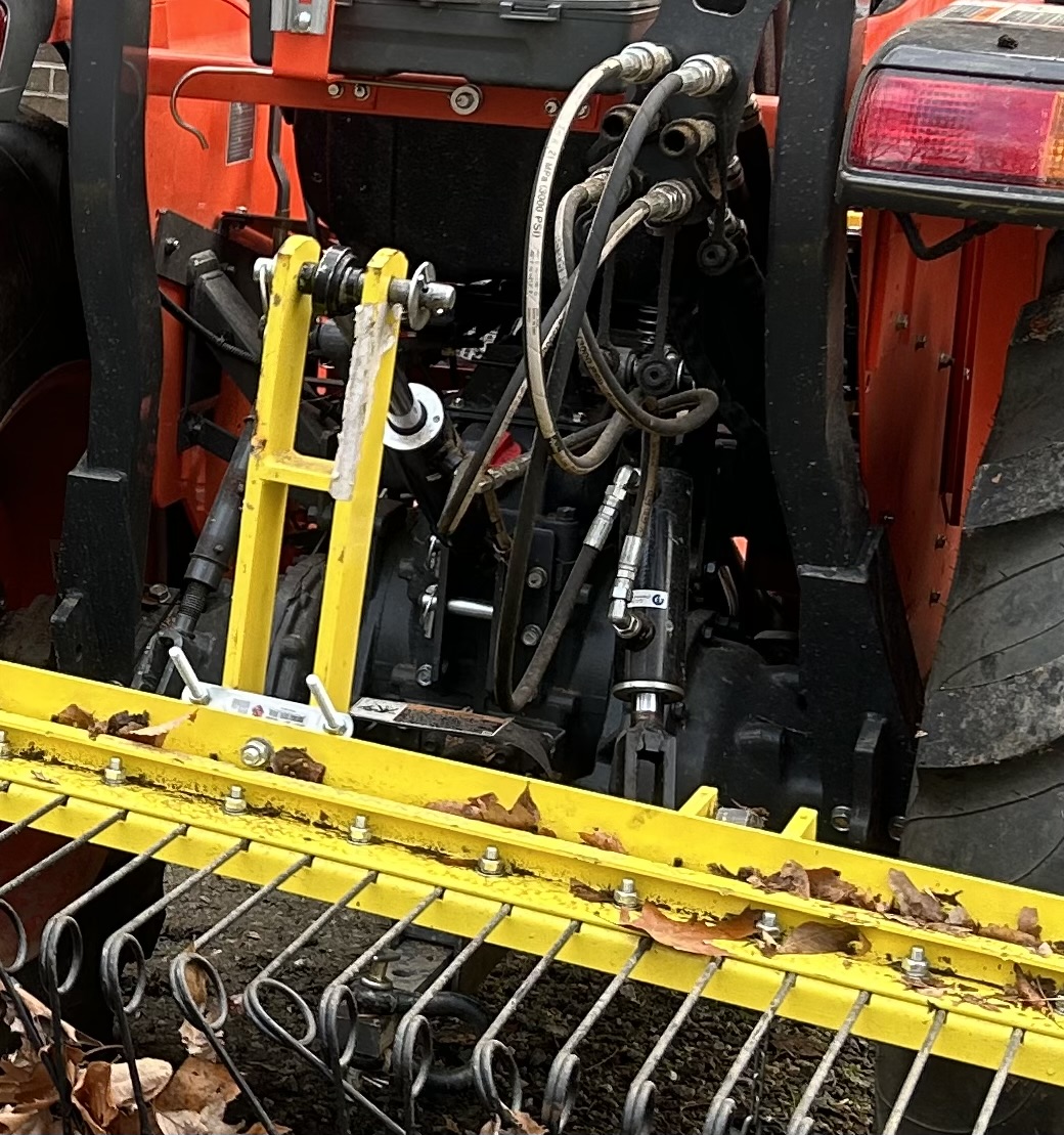

What is top and tilt? What are the remotes and what are they used for, please. Thanks

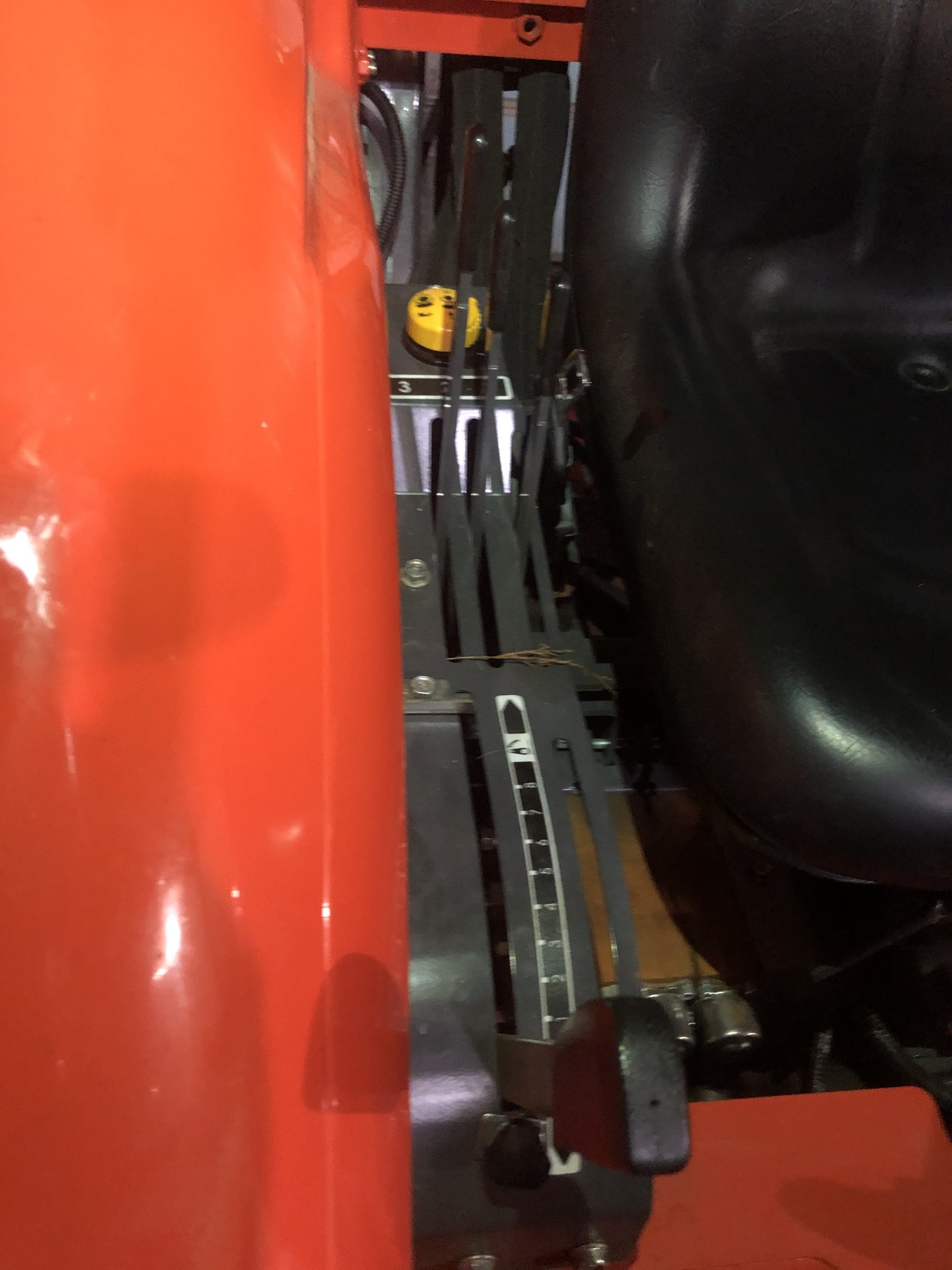

This is a top (hydraulic top link) and tilt (hydraulic side link). The things the hoses plug into toward the upper right of the pic are hydraulic remotes. A pair runs one cylinder.
Instead of manually adjusting the toplink and side link, I adjust them with two of the three little levers that are by my right hip when I’m in the operator seat. That allows adjusting while moving, adjusting very quickly, and (because I chose a float detent for one of the valves) I can allow the side link to float to follow land contour when grading. I can float the top link, which is sometimes useful for brush hogging. If you do much grading, it’s really sweet. If your tasks don’t require much adjustment of the three point, may not be of much benefit.
There are a variety of implements such as rear blades with hydraulic offset and tilt, offset flail mowers, etc. that have hydraulics on the implement which require one or more remotes on the tractor to run. Personally, I don’t have any implements that require remotes, but it isn’t uncommon. Just depends on what jobs you have,
View attachment 153454 Instead of manually adjusting the toplink and side link, I adjust them with two of the three little levers that are by my right hip when I’m in the operator seat. That allows adjusting while moving, adjusting very quickly, and (because I chose a float detent for one of the valves) I can allow the side link to float to follow land contour when grading. I can float the top link, which is sometimes useful for brush hogging. If you do much grading, it’s really sweet. If your tasks don’t require much adjustment of the three point, may not be of much benefit.
It’s especially nice with a rear blade. Bef getting the hydraulic remotes and cylinders, I was constantly hopping off to adjust tilt, angle, and offset.

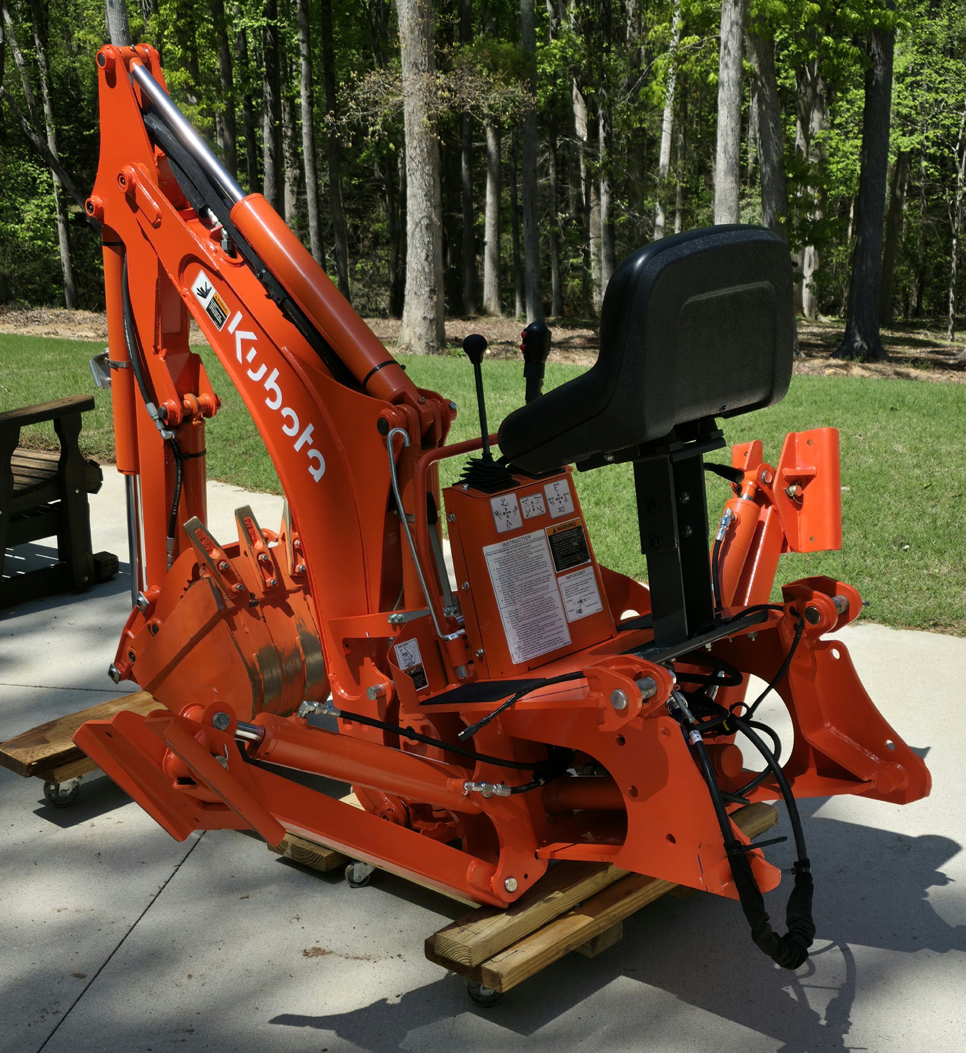

Great information thank you very much. In my case I'm never going to use a snow plow or grapple or the excavator like the bh77. For me only thing I'm going to do is ground leveling moving rocks and using the rape to remove the vegetation that grows in the forest area. I just need something that's strong enough to be able to lift the rock if I need it taken out of a garden area where the tractor will be riding on turf. That's why I chose the R14 tires with the wider stance of the 43x16-20s. Thanks again for your help.

I see that you already have a BH77…the rear remotes will be a good feature as mentioned by others…but I added them for what has turned out to be the handiest feature of my rig…

I had the exact same backhoe the bh77, with the hydraulic thumb but I did not have that long hydraulic cable that you show. Mine was built into the structure of the arm of the backhoe. For me it really was a waste because I didn't need to grab a hold of much of anything when I was lifting rocks or tree limbs things like that I used the front loader. I only use my backhoe to dig an 18 inch by 12 inch hole for the remote home we built adjacent to our home on the 4 acre property. Other than that, it sat in the garage and collected dust for 4 years. So I sold it when I sold the l-2501 hsd. Thanks so much for your help
