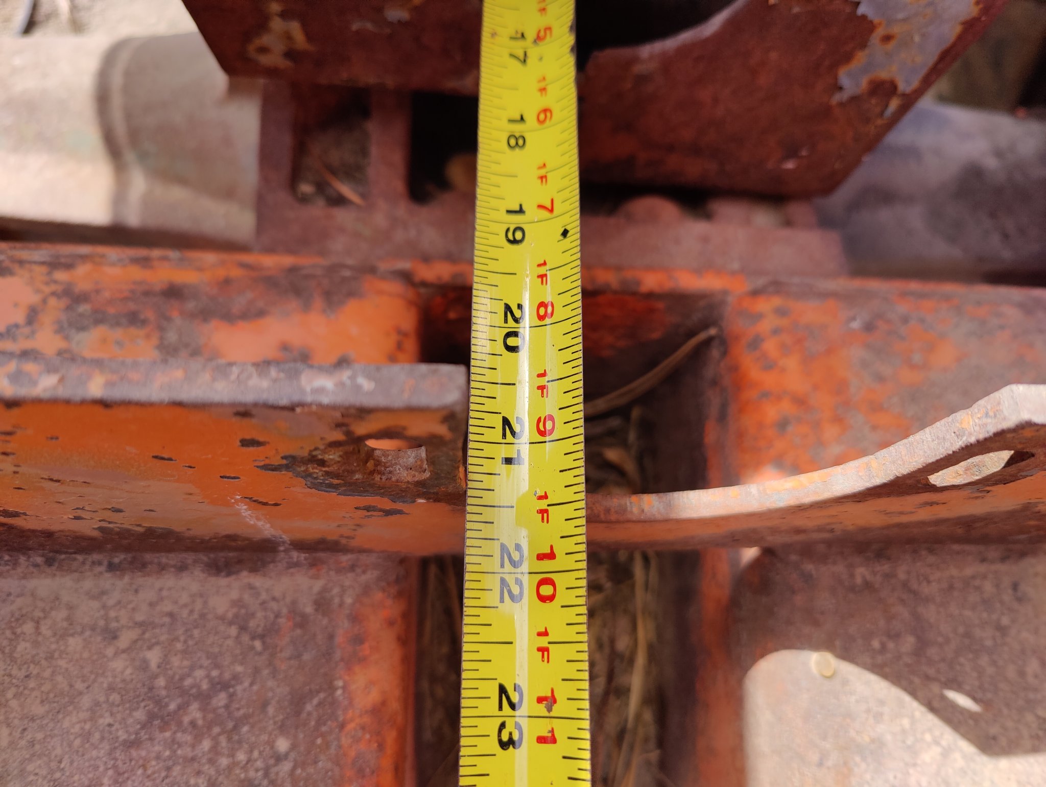

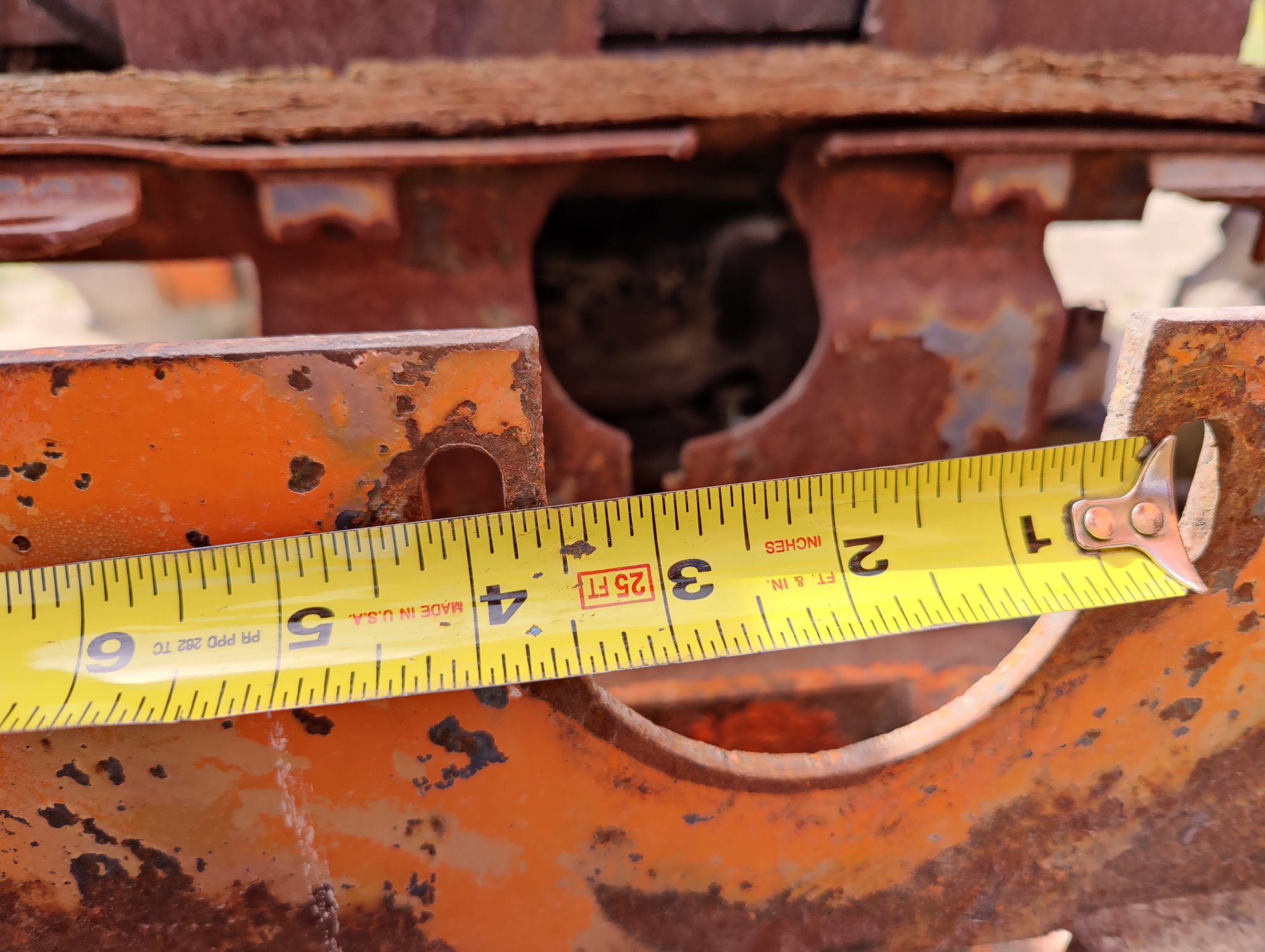

I do not have any of #50 parts. Heres the loop for those couplers - includes the master link. Shipping to Oklahoma probably a lot cheaper than the east coast.
Forgot to measure the diameter of the sprocket, but I will be back up there later. The holes for the pump are 4-3/16" apart and the face of the sprocket is 21-3/8 from the face that the pump mounts to. IMG20220527112858.jpg IMG20220527112831.jpg

Forgot to measure the diameter of the sprocket, but I will be back up there later. The holes for the pump are 4-3/16" apart and the face of the sprocket is 21-3/8 from the face that the pump mounts to. View attachment 80856 View attachment 80857
That's setup for an SAE A flange - dead on the money at 4.188 bolt circle. It would be a direct bolt on pump. Those pumps max out at around 2 CID which gets you 20 GPM @ 2500 RPM.
If you wanted to move up to a larger SAE B flange pump you would need an adapter plate. Real simple to make - just a piece of 3/8 thick plate to act as a spacer with a 4.5" pilot hole and two 4.75" bolt holes. You would have to drill two new holes in the tractor flange. Those pumps can easily hit 20+ GP @2000 RPM. They are also considerably larger. How much open space is there to fit the pump in?
