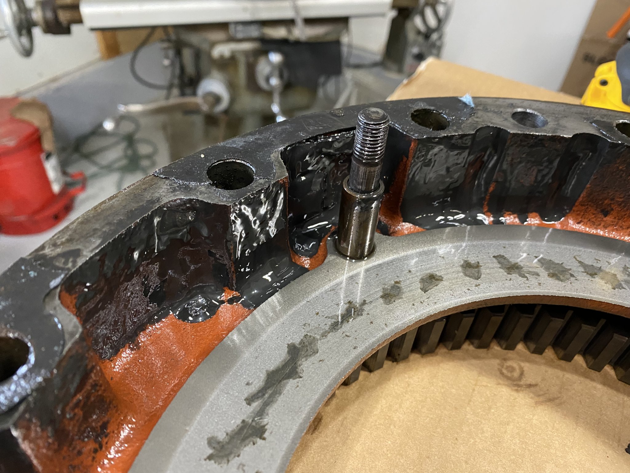

I have a sludge that is not dissolved by hydraulic fluid. It is the consistency of grease. this is my brake assembly housing but I am confident that this sludge is present in the transmission. The brake discs failed and pieces of brake fiber are mixed in w this sludge.
If not diesel are there other additives/solvents that are ok to use?

I have used Seafoam to dissolve gunk in gas engine crankcases. Rule of thumbs 1) Ratio on no more than 1 part Seafoam, 4 parts old oil. 2) careful not to overfill.
Before adding, get oil warm by running engine. Drain out some oil, see above ratio, refill with Seafoam. Run engine about 5 minutes. Drain crankcase and refill with proper oil and amount.
I'm thinking similar procedure with hydro fluid, maybe not as much Seafoam.

Sorry forgot to add the model is an M4500. 1980 ish. Plenty of hours but sat for probably 5 years. Was on a working orchard.
Brake cleaner dissolves the sludge but I have no intention of running it through the pump...
