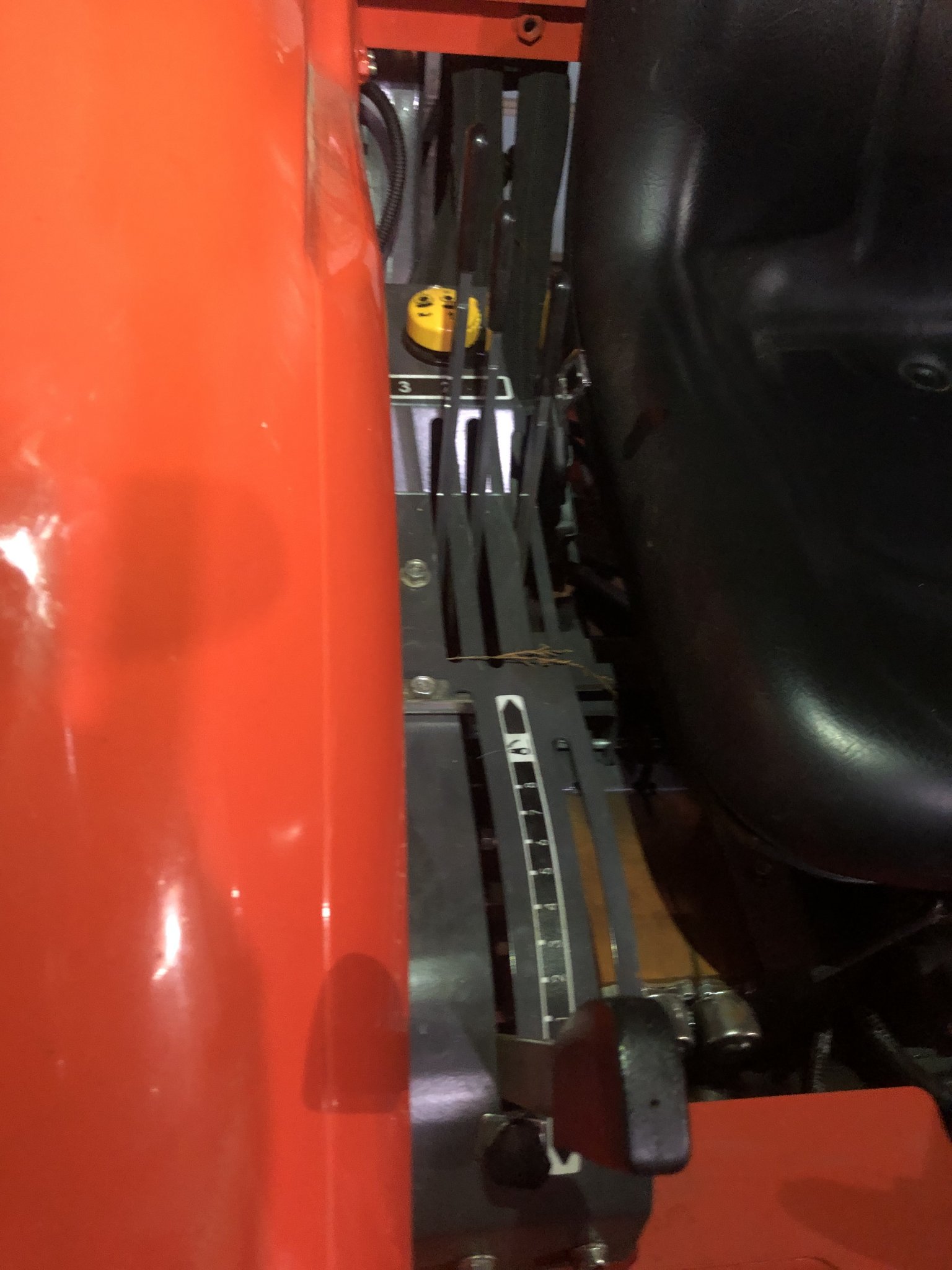

Regardless of rear remotes, beside and slightly below your right hip as you sit in the seat there’s a rather large lever that controls the 3 point. Just above and behind that there are slots. Without OEM remotes there’s nothing in the slots.

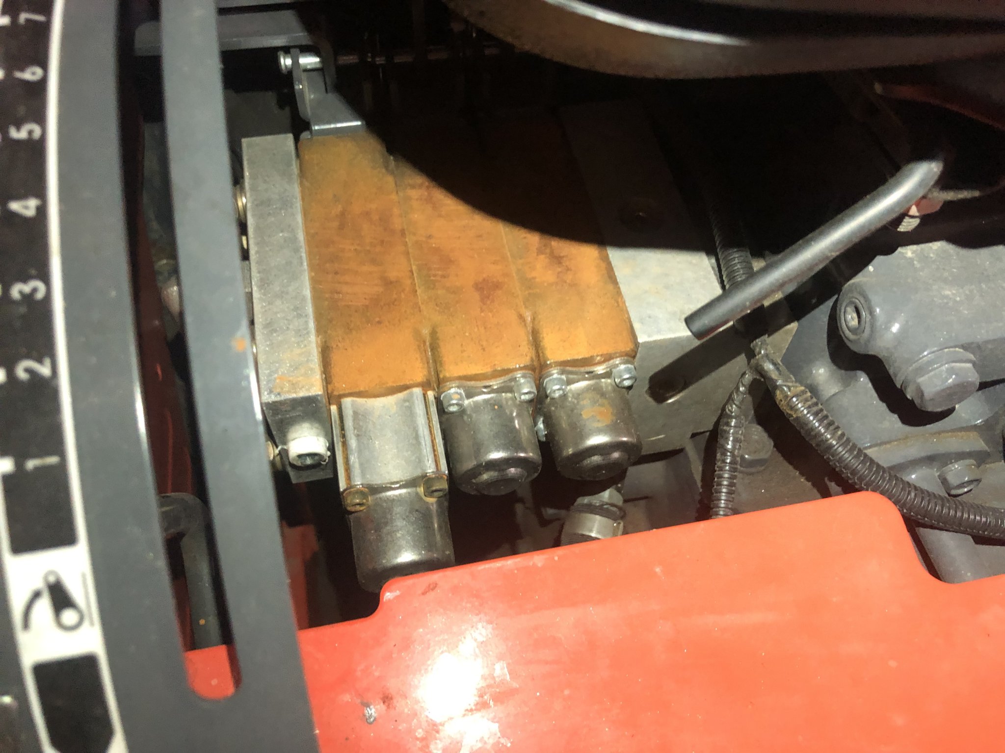

With OEM rear remotes, there are one, two, or three hydraulic valves mounted on under the right side of the seat. In this case, one is larger than the others because it has a float detent whereas the other two are center returns. The first one (closest to center of the machine) has to be a center return due to insufficient space for a float or continuous flow detent. The second and third can be detents if you wish.
The controls for those valves fit in the three slots above the three point height control. All three control levers are different heights so you can reach down and easily tell which one your on by feel without looking.

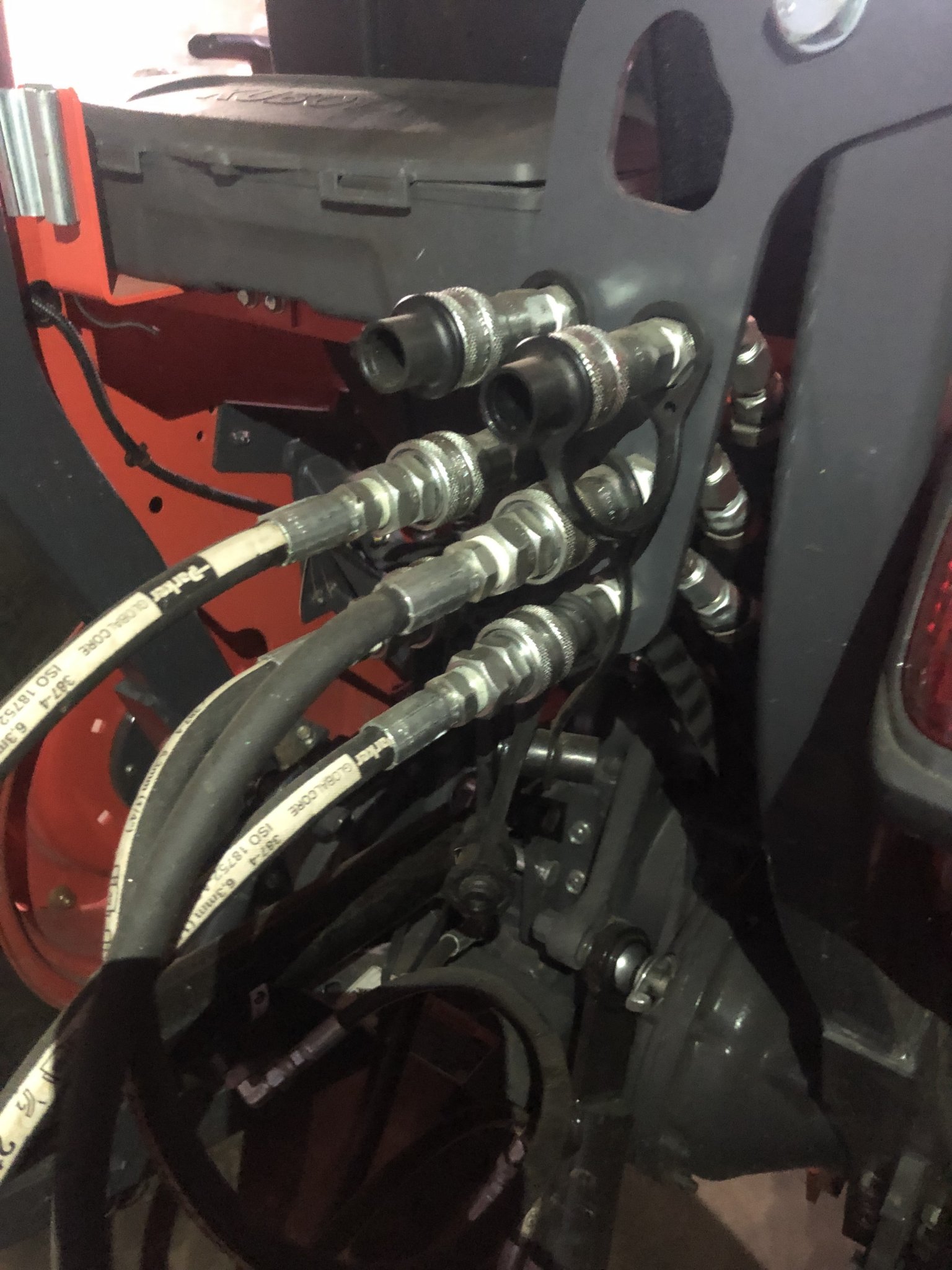

The actual remote connects are stacked on a bracket on the right side of the ROPS. In my case, they almost always control the hydraulic top link and side link with one left over. I normally have the float detent valve hooked to the top link but can float the side link by swapping the hoses at the quick connects. I prefer ability to float the top for mowing and prefer to float the tilt for pulling gravel out of ditches.
I don’t currently have a specific use for the third remote. I had it installed at the same time as the other two because a significant element of cost is labor due to having to remove and reinstall the right rear wheel and fender for access. At some point if I get ambitious I may add a hydraulic cylinder to my manually adjustable back blade and if that ever happens I’ll be needing the third remote as I’m not giving up the hydraulic top and tilt for grading work.

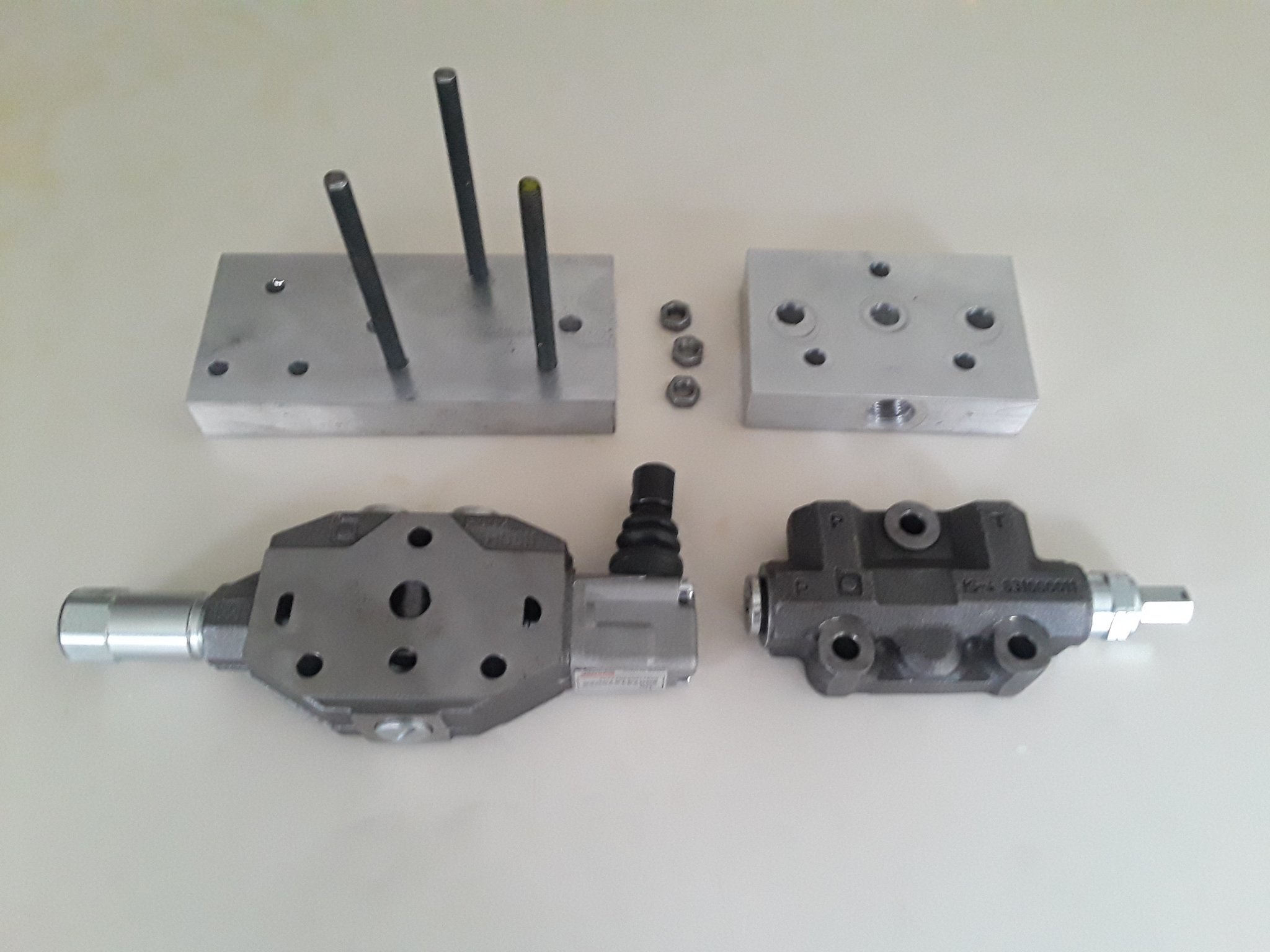

Thanks for those pictures. Very similar to the L2501/L3301/L3901 but I see one major difference. The valves are mounted upside down with the work ports on the underside. There are also custom made inlet and outlet covers on your stack.
I have the installation manual for one of the earlier versions of the kits used on the smaller HP machines and it too had the valves upside down but the current kits have the work ports mounted right side up so that may be a reflection of the vintage of your machine. I can't see the tractor connections to your stack - are there one or two hoses in addition to the work ports.?
