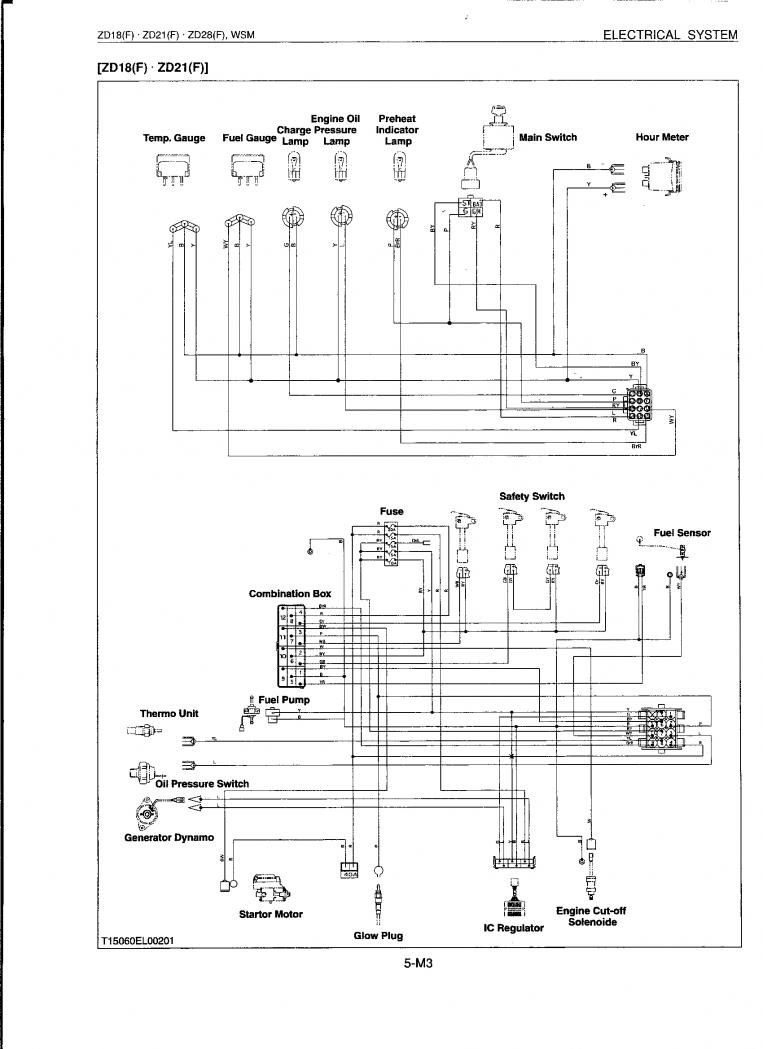

James I own one of these 2001 S/N 30310 and have the Work Shop Manual. Let me think about this over the weekend and get back to you after a review of the wiring diagram and the circuits energized during the glow plug preheat pole continuity on the ignition switch in the start position. Don't do anything to jeopardize the integrity of the combination box. ( All Safety Interlock Micro switches feed this black box under the passenger side fender deck ). It will simply keep the starter soleniod from receiving the voltage to the starter reduction gear. I'm sure we can figure this out. :)

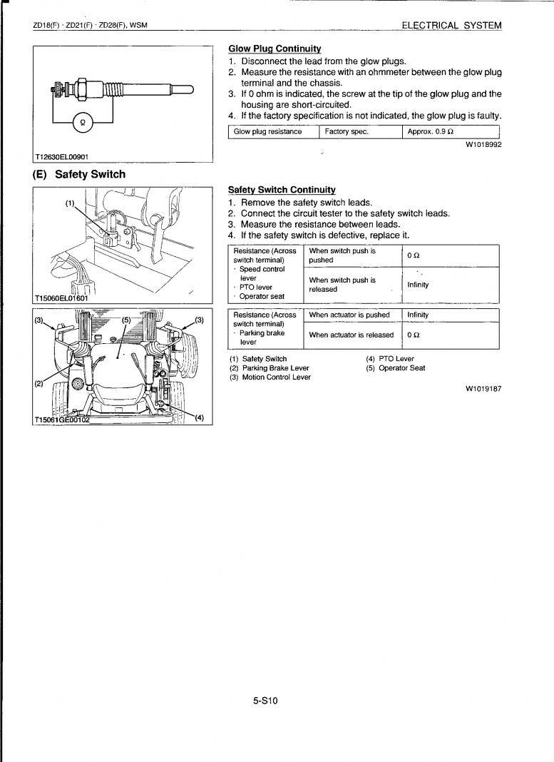

James connect a remote start switch at the starter solenoid ( 12 Guage wire Black/wht tracer) between the battery terminal and solenoid terminal at the starter motor. Bump the switch and if it cranks your problem is in the safety start system. I will try to attach the electrical diagrams. My tractor did this once and it was the seat switch and I had to replace it because the combination box requires a certain resistance in the circuit to cause the micro-processor to allow voltage to the solenoid for start up with the key switch. :)
Post back if you don't find it...

Thanks for the quick response. My problem is in the safety system. I carried it to my local dealer, hopefully it won't be nothing to serious. I appreciate the electrical reference pages, I am sure they will come in handy, I am keeping them with my manual for future use.
