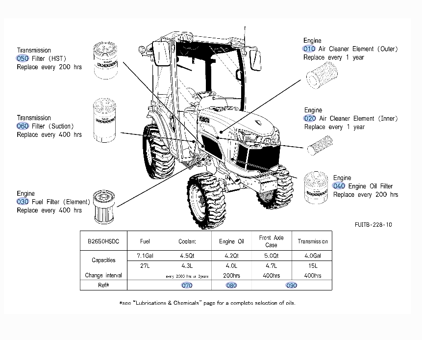

Hi,
I have a B2650 tractor.
I am confused about the Transmission filters. The Manual says that the Transmission Filters should be replaced every 200 Hrs and the Hydraulic Filter should be replaced every 400 Hrs. It clearly says Transmission filters, not filter. So are there two Transmission Filters and one Hydraulic Filter?
Thank You

There is 1 transmission filter and 1 hydraulic filter.
I change both filters at the same time.
Good look.
Good look.
Agreed.
Mistakes in Operator's Manuals are not uncommon.

So you didn't get under the tractor and look at the filters? This is the "frequently used items" drawing for the B2650 from Messick's website.
